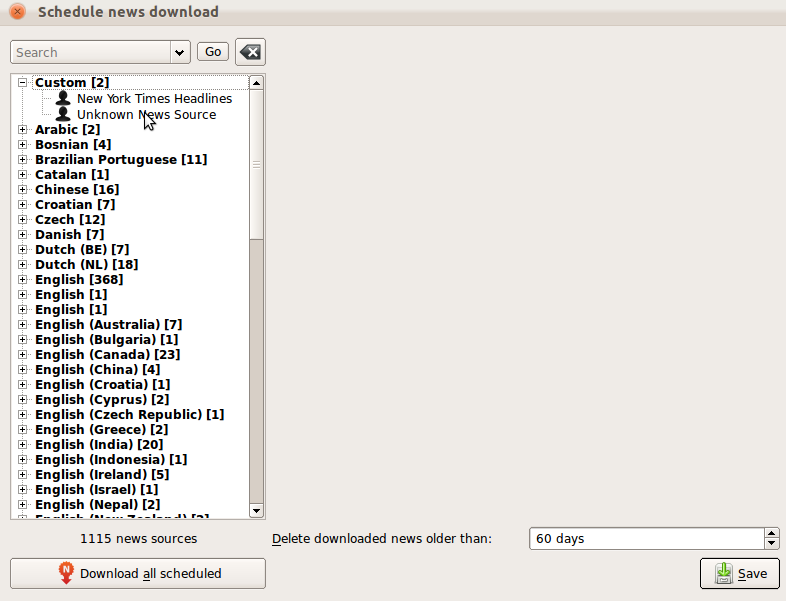

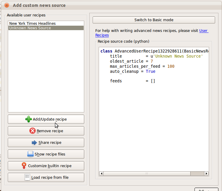

In "Fetch News" -> "Add a custom news source", make sure after you finish editing the recipe, click on the "Add/Update recipe" to save your work. The name of your recipe will be shown under the "Available User Recipes" list on the top left of the window.
Then in "Fetch News" -> "Schedule News Download", you'll see your recipe under the "Custom" branch of the news source tree on the left.

I got it! Guess they left that part out of the manual
