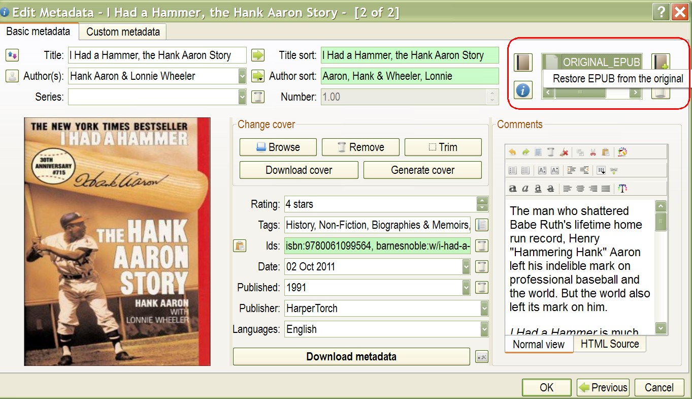

Originally Posted by LbrtyorDeath View Post
I don't see "Restore EPUB from Original anywhere.....
Select a book.
Click Edit metadata icon.
Right click on ORIGINAL_EPUB.
Click on Restore Epub from the original.
See attached.
Or wait until tomorrow and upgrade to 0.8.27 and restore them all at once.
