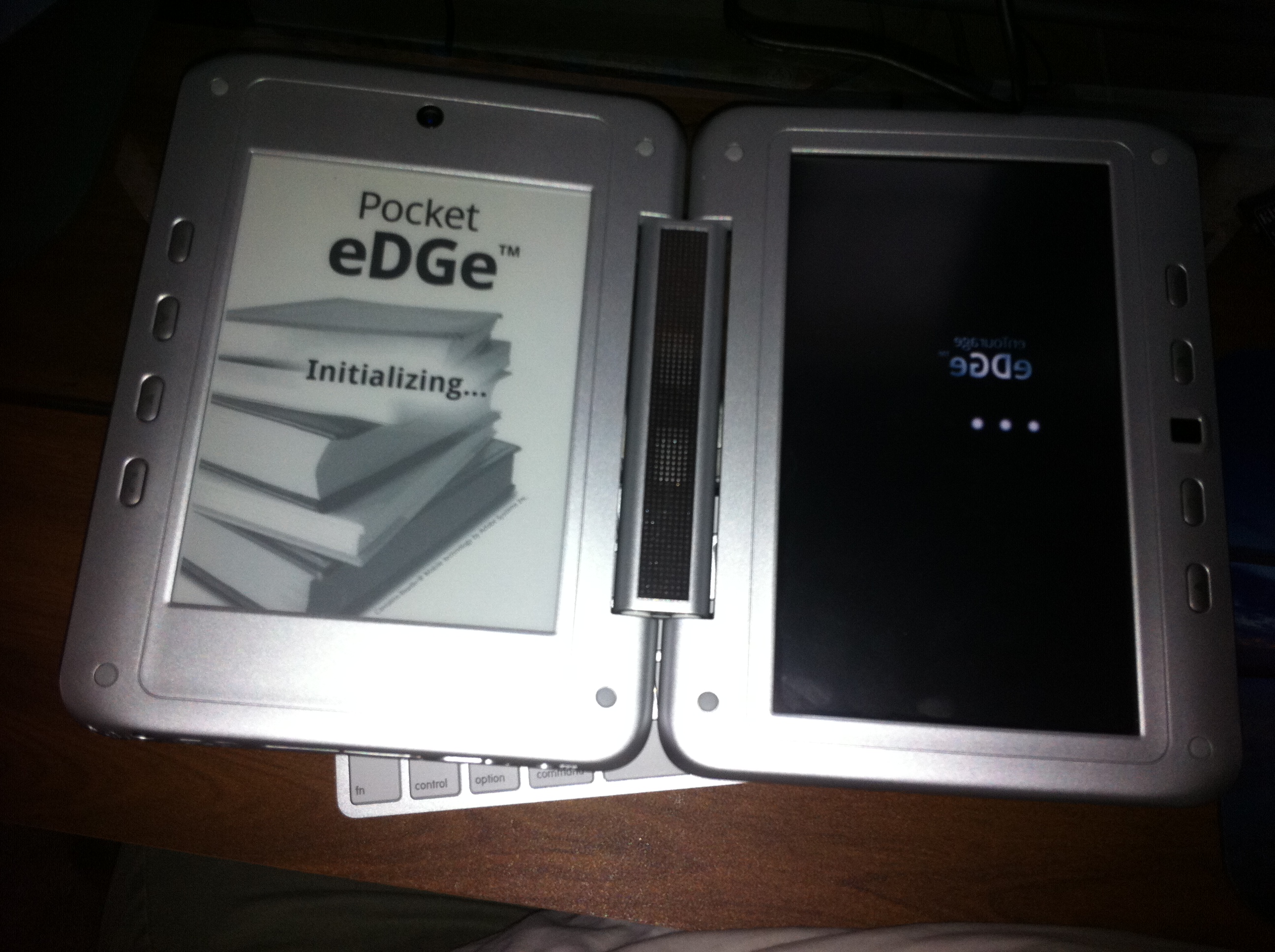

Well, I was one of the folks who opted for the $80 Pocket Edge on Woot. After updating to Ermine, I have been in heaven. This device is seriously my dream device, minus the fact that it could be a little faster and a little more stable.
Unfortunately, today, I plugged my edge into my mac to attempt to authorize it with Adobe. It crashed. On restart, it went into a reboot loop. I used the reset button in hopes that after coming back up, it would start successfully, but without luck. It went back to the reboot loop.
I attempted to reflash Ermine, and it seemed to take, as it showed the upgrade screen, but afterwards, it continued to do the infinite reboot.
I can't find downloads of Dingo anywhere since the links all point to the down Entourage site. Most of the un-bricking threads seem to point to Dingo, or to threads that no longer exist because the Entourage site is down.
Halp?

Yeah, I finally found and downloaded the dingo in the last post of that thread. I've flashed it, and while it is no longer stuck in a reset loop, it has interesting new symptoms:
1) LCD side is inverted. Not upside-down, or rotated, but inverted. WTF.
2) Machine never gets past 3 dots in the boot phase.
Sigh. I did think from the comments on Woot that this thing would at least *work*. I had the bad experience of buying the damn iRex device (for full price!) that broke shortly after they went under, but I thought that this one would be okay since it has an active community and runs Android. Oh well, this time only wasted $80.

Thanks for your feedback everyone. Obsessed2, this is actually my second broken device, the first was the iRex, which is only broken in that it has no 3G and there's a spot on the screen.
I've tried to reflash several more times, once with each of the zip files mentioned, but had no luck. The device no longer goes to the "updating" screen, which indicates that it is trying to apply the firmware. Instead, it displays the inverted logo, goes from one to three dots, and then e-Ink side flashes for about 30 seconds, before switching to the Initializing screen. The LCD side continues in the inverted state, as shown in the picture below. Any more ideas?

Yeah, based on some other threads, I guess I'll just keep trying. I know I am doing it right, because I succeeded in updating the device to Ermine once already with the same microSD card, etc. Here's hoping it magically starts working.
I've thought about taking it apart to see if something is physically wrong with the menu/rotate buttons, but it seems I do not have an appropriately sized screwdriver for the job, which is a bummer.
