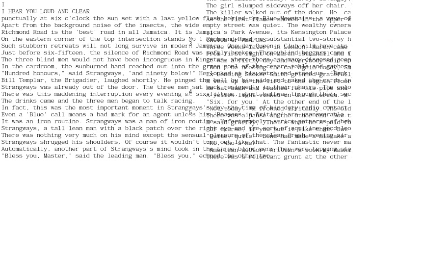

Overlapping text
I'm new to the whole e-reader scene and have an issue with some books in the ePub format. Some of the text is overlapped and the page setup doesn't seemed to be sized correctly as part of the text is cut off on the right side of the page. Can anyone suggest how I can edit to file to correct the overlapping text?

That's an epub?? What the heck are you using to read that with? Where does the epub come from? Is it encrypted? (also known as DRM'ed)

I'm using kobo to read it, but the image comes from Adobe Digital Editions. I don't believe the epub is encrypted.

That seems to be a problem with Kobo's non-Kobo epub version AFAICT.

Without a sample of the offending epub to look at we here will just be guessing as to the problems associated with it as we can not see for ourselves what might be the matter. In this case my guess is that it is a grand rodent conspiracy between marmots, beavers and groundhogs to distract us from their schemes to take over the world.
Having said all that you are in luck as I suspect I do know what's "wrong" with your epub. I notice that the typeface in your JPEG example is fixed-spaced leading me to believe you epub is plain text file in disguise and that were we to look into it we'd find lots of paragraphs that look similar to <pre>This is the text.</pre> hence the rendering issues.
Any others willing to concur?
Close. There was only one <pre> (for the whole thing)

Originally Posted by jeeperz View Post
If that's what's wrong, how do I fix it?
Find a better source for you illicit books

You need to contact the publisher and complain about it. There's absolutely no excuse for such appalling formatting. Where did you buy the book from? Kobo?

Quick fix using Calibre instructions:
Use the tweak epub feature to 'explode' the broken books. Find the html files (in the Oepub directory, I think) and open them with a a text editor. Copy and paste the text of the book into a new .txt file, but discard all the html code. Close all files and cancel the tweak operation. Add the new .txt file into Calibre and convert to epub. The final book format won't be very good, but should be readable, for the budget concious.
