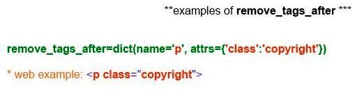

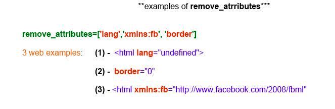

I was able to study your old and new revision of this work, and was finally able to figure out what needs to be seen in the HTML in order to write up some of the special code when we want certain things to be omitted from a site. I really appreciate the little you gave me.
Before, in #6 above. I mentioned on how important it would be if you 'guru' guys would be able to make a tutorial that would show examples of what to look for in the HTML code of a site. This way we "newbies" can help ourselves. Now I suck at making these tutorials. Plus I still haven't figured out all the codes to understand how to work out a recipe in full. Hopefully my examples below can inspire a better idea from you.
Here are three pic examples on what I mean. And the site I wish you guys would give examples to is: http://manual.calibre-ebook.com/_mod...eeds/news.html
ID:	76617   Click image for larger version
ID:	76619   Click image for larger version
