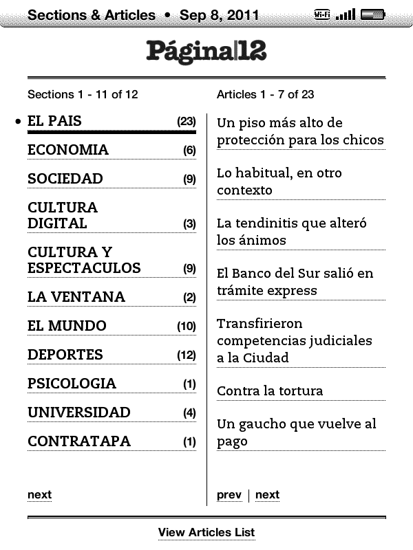

The built-in recipe for this Argentinean newspaper (based on the RSS feeds) has one major flaw: too many articles (usually, more than 60) in just one section.
So, I manage to create a recipe (based on "The Atlantic" one), that search for sections in and index page, thus "categorizing" articles (see image attached).
Besides, I've created another recipe, that retrieves more articles that appears on a weekly basis ("Suplementos").

Why making the recipe for the suplements? They are already included (all of them) in the existing recipe.

They are, indeed, but for some reason I get a lot of empty feeds (I think there's something wrong with the RSS feeds from the newspaper itself)...
