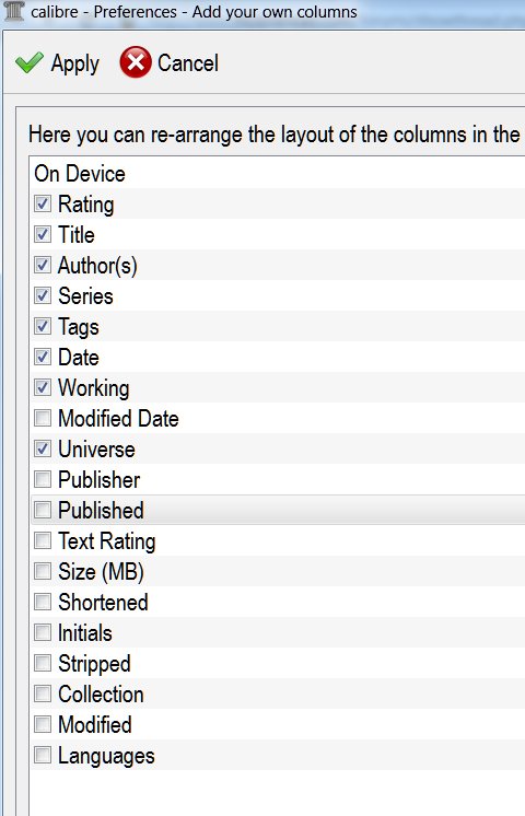

Originally Posted by eezergoode View Post
@dwanthny : It is the standard ISBN column, if you aren't seeing it, you may not have it enabled, or it could be off the right edge of your screen.
When I review (see attached) the list of calibre and user defined columns I don't see a "standard" ISBN column and I couldn't have deleted it since calibre doesn't let you delete non-user defined columns.
Update: I took a second and looked around, calibre does not have a ISBN column by default but under create custom column it does have a "quick create" feature to allow you to create a custom column called ISBN. So I don't have it because I never created a custom column for ISBN.
