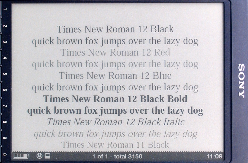

Manual focus
I attach a photo taken with Canon Powershot Pro 1 in dim daylight conditions (in the middle of the room with venetian blinds) at 100 ISO. The original is much more difficult to shoot than a black and white paperbook, because the Sony screen is greyish. The focus was set manually.
For other examples see:
https://www.mobileread.com/forums/sho...958#post105958
or my thread on do-it yourself repro v-cradle in Sony Reader Accessories forum.
