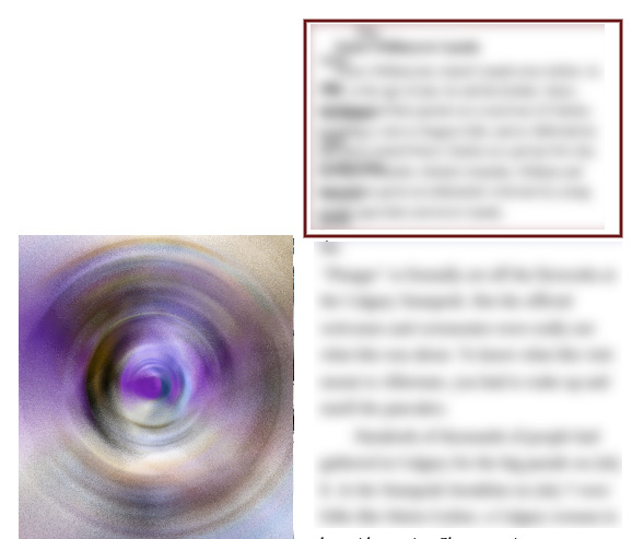

I'm still having an issue with my textboxes though, which don't seem to play nicely when beside a photo. Do you think it's because the width is set too wide? I have them set to 48% each, but I sometimes get run-in between photo and box of the main body text.
Here's the example: The purple blob is the picture, the white space on top shouldn't be there, and the red box is a textbox. You can see in the text box that the left side is a bit heavier with text, it's run in from the below main paragraph.
Here's the code for it:
div.textboxright {
  float: right;
  width: 48%;
  border-color: #660000;
border-style: solid;
border-width: 2px;
  margin-left: 0.25em;
  padding: 0.5em;
div.imageleft {
float: left;
 width: 48%;
margin-left: auto;
margin-right: auto;
margin-top: 1.00em;
margin-bottom: 1.00em;
padding-right: 0.5em;
padding-left: 0.5em;

You could put align="left" in the img statement, eliminating the divs altogether. That is deprecated but it does work in Sigil.
If you are developing for a particular device you need to test in a reader for that device. From what I have read, mobi does not support it. Since I am a Sony guy, I can't really say if it is true or if there is a way to work around it.
And not all devices support everything the same way. You can not center a heading easily using styles in Sony. It shows ok in Sigil, but does not show that way in the reader. But the old fashioned <center> command does work.
mrmikel is offline   Reply With Quote

The align tag still gave me odd spacing, but thanks for the suggestion. I was able to put it to use at the ends of paragraphs. I'm mostly testing with ADE, and an iPad.
The text boxes just don't seem to function properly beside a picture, so I've just moved them a bit so that there's no overlapping. I'll put that on my project list to figure out when I'm no longer swamped.

Well, if you're testing on iPad, first a) check to be sure that you have tested it both with the full-justification "shipped-with" setting turned OFF, and with it on, and b) that you put !important after the width and the float declarations, because Apple sucks and ignores half of what you say vis-a-vis CSS. Lastly, I can't help but note that although you've set your widths in %, you've set your margins in ems and your border in px, which might--just might--add up to more than 100%? (n.b.--I didn't do the math, because I'm lazy, but it's a possibility).
