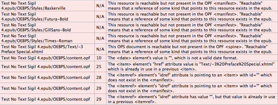

Sigil 0.4.0RC1 seems to corrupt the content.opf file under certain conditions. Does your finished epub pass FlightCrew checks?

testing with FlightCrew
Good idea, thanks.
If I edit the file in Sigil 3.4, it validates, but tells me that the file refers to some fonts that it doesn't embed. That's expected. I get the same message before and after adding a cover.
But with 4.0RC I get some new messages.
I've attached a screenshot. Hopefully that'll come through. The first five errors appear with both versions. The last four only appear with version 4.
Thanks,
Steve
