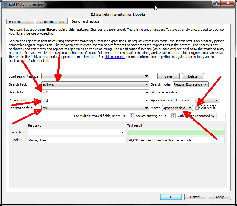

Are you using bulk metadata edit search/replace? If so, you haven't noticed the Mode box, which gives the options of replace, prepend, and append.
See the attached screenshot. Fields of interest are indicated with a red arrow.
