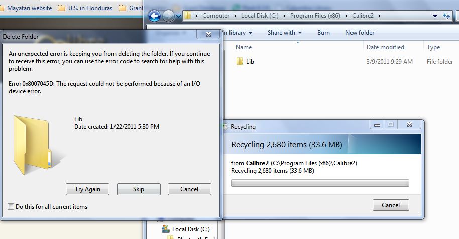

I've never had anything like this happen. I had Calibre 0.7.44 installed on a Windows 7 AMD 64 PC. It ran fine for a few weeks. Then one day it would only crash with some kind of Python error.
I tried to repair the installation, but that would slow the computer to molasses speed and crash. Then I tried to uninstall, and that slowed worse before giving me error messages that I don't understand.

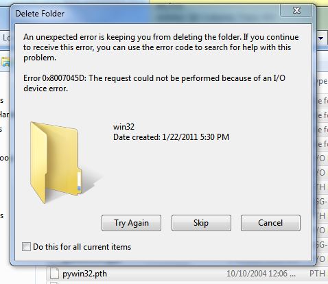

Then I tried to manually delete the files under c:\Program Files (x86)\Calibre2. First my computer would lock up and go super slow, with estimated delete times of like 2 hours. Then I wouldn't be able to delete the files at all. I am getting strange IO error messages (screenshots attached) every time I try to delete Calibre2 files. Eventually, I was able to delete everything but the Lib directory under Calibre2, but those files still remain, and every time I try to delete them, uninstall Calibre, or Reinstall Calibre, my computer locks up.
What can I do to just get rid of this annoyance?
I tried posting this message several to the Calibre website bug tracker, but it never seemed to stick, which I don't understand. (As if an Admin were deleting them.)

Windows ? -> reboot
Hi there
First step is to reboot your computer.
Then you should check your disk(s) for any errors, AND correct them, if there'r any.
What Antivirus are you using ? You might want disable that while strugling with this problem.
DON'T use the Internet while antivirus is disabled.
Oh yes, are you THE administrator when doing all these steps ?
Don't have windows 7 myself, but vista,
One more thing: is EVRYTHING Calibre related, programs, library etc. located on the c: drive ?
Sorry that I don't have the magic solution for you.
Hopefully someone else can help you, but you might to give us all some more info.

This looks to me to be a hard disk failure. Can you run a disk check (see the device properties)? Also, try to get a SMART status or some other hardware diagnostic- refer to your drives' manufacturer for instructions how to do that.
Apart from that: Is Calibre the only program affected by this?

Oy vey ... Maybe it is a disk problem. The computer is relatively new. I just ran chkdsk and it found some bad sectors. I still can't delete the Calibre files although now it's a different error message (I need permission from SYSTEM to do that).
Yes, Calibre files are the only files affected that I know of, though this computer has a lot of problems running a range of programs that might be due to something like this.
It's a work computer for a rural nonprofit in remote Honduras, so getting things fixed is a problem ...
Any advice? I know it's probably beyond the scope of this site.
