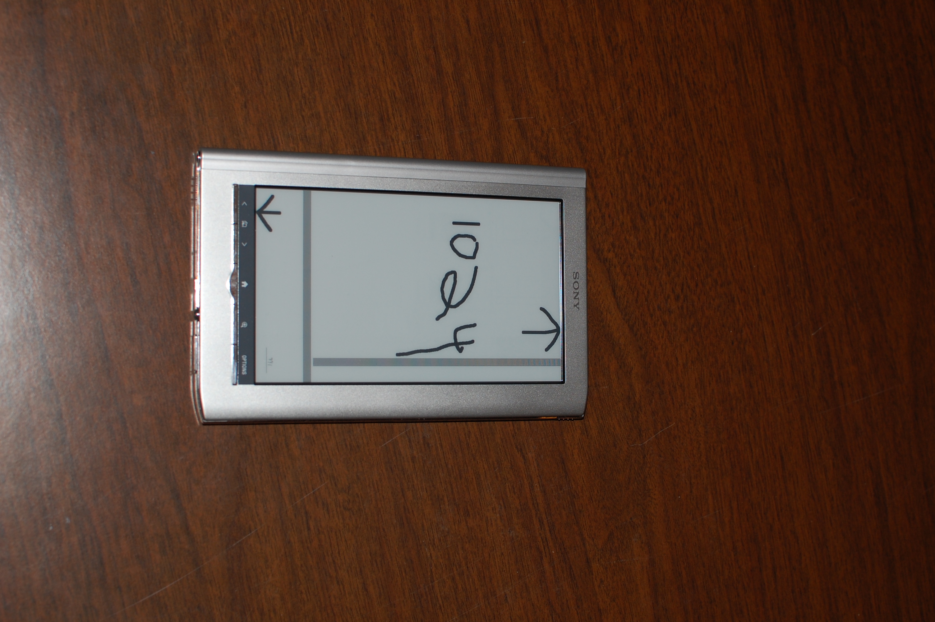

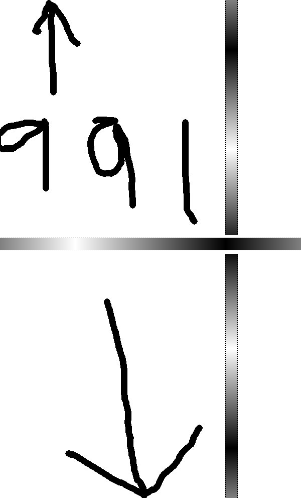

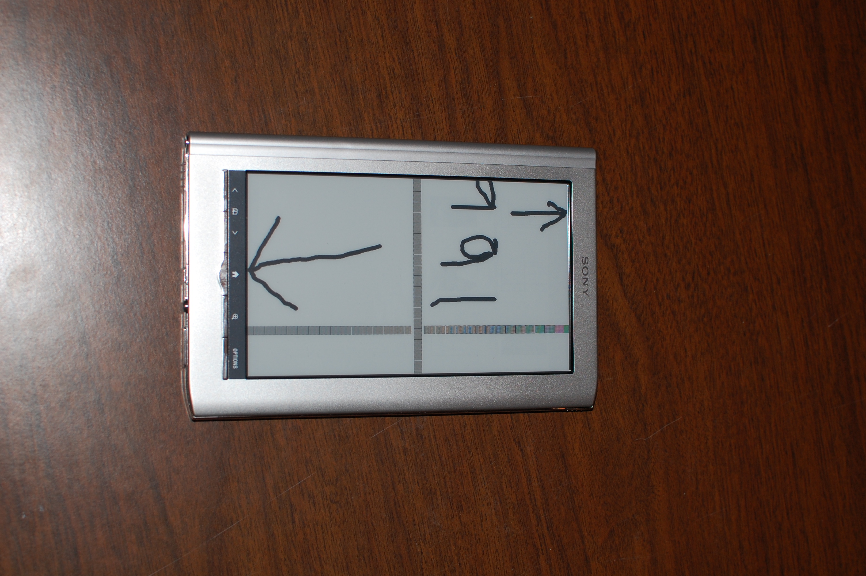

I did some tests with some quickly GIMPed JPGs. The 600x991 image is definitely being scaled to fit the screen, and the 600x1024 image is displayed pixel-for-pixel. If you're (as I am) cropping JPGs of your family for wallpaper, go for 600x1024. Beats me why Sony used the smaller resolution (true on the 350 I had briefly too).
EDIT: adding the jpgs I used for test.

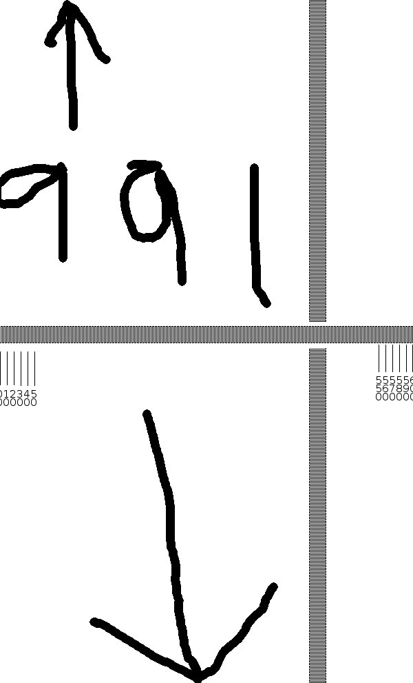

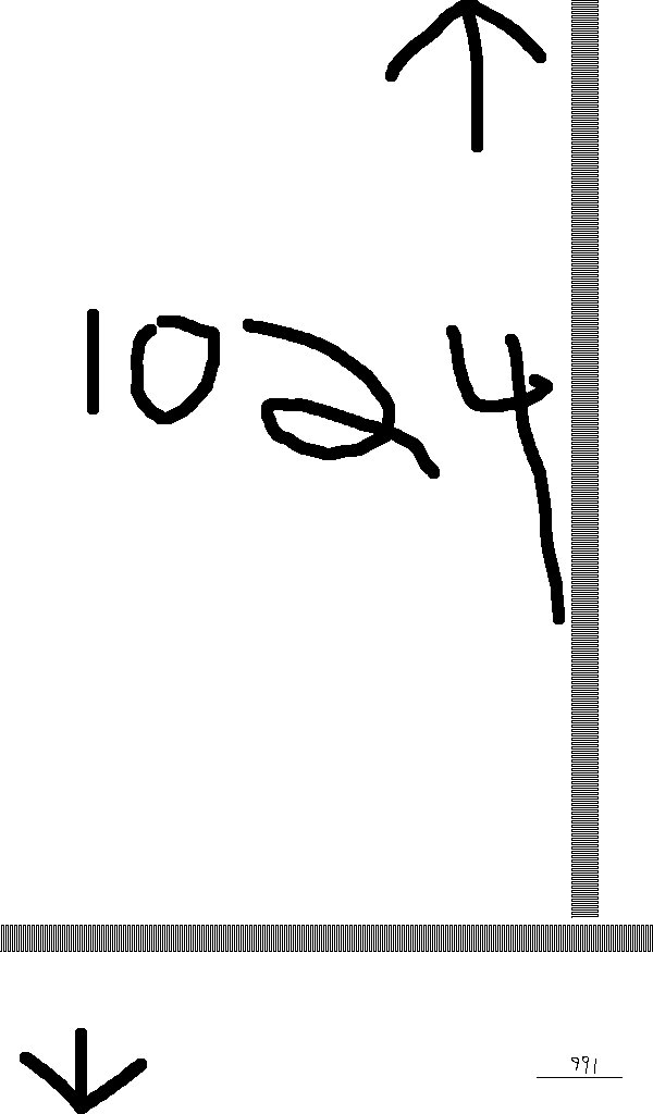

I did some more testing and it appears that the Reader is scaling proportionally. The 600x991 was being scaled up to 620x1024 to fill the screen, and then the extra twenty pixels were cropped (ten from each side).
Eric
