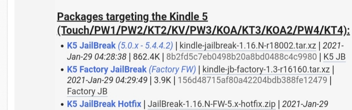

@dhdurgee8 for my Kindle version they have packages but for a much older firmware, I put a screenshot here
@hius07 also, what i saw there is much older firmware, i don't know what to make of all that

Serial port operations don't depend on the firmware version.

So I can flash the package there without any issue, even if my firmware is very new?
That is pretty much the point of using the serial port.

Ah thank you, in that case i will order the serial adapter and get jailbreaking. Thank you!
