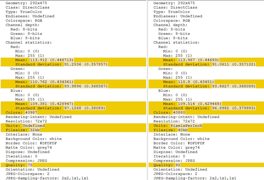

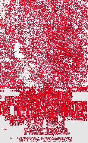

hi no it dosent change the dimensions.
im currently still investigating details but in all files the changes are present.
i extracted the DIFF of the image changes and you can see them attached.
if you look at the compare.jpg you will see the Quality settings changing from 75% --> 92% so it seems calibre is doing a preprocessing of the files before rewriting them.

It uses the same code path as adding books, which processes images to normalize them and replace transparent backgrounds with white ones.
