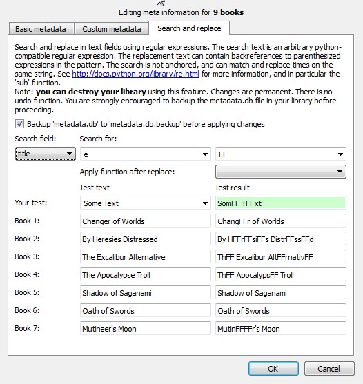

Teaser ...
I de-pontificated myself and have been playing with bulk edit. Something like this might actually appear ...
metadata, replace, search
