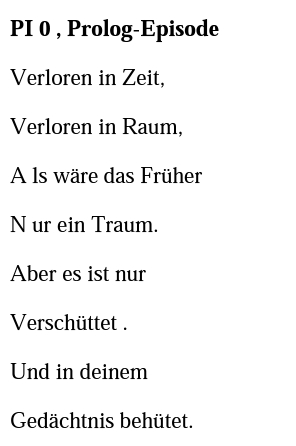

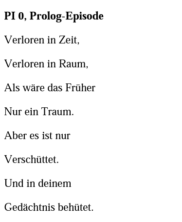

I tried to do this with sigil but I get strange results. Opening the .epub with
the sony library software seems to be okay but with sigil I get a lot of blanks
into the words of the file. If I save the document then the blanks are included
in the document.
I think the problem is the scaling of the font size - I get the same problem
with calibre if I use the fontscaling there.
Is there a possibility to switch off the scaling of the font size in sigil?
What else can I do?
Enclosed you can find screenshots showing my problem.
Thanks a lot in advance,
Regards, Franz Peter.

The same problem is with all files I tried. I wrote the text (part
of a science fiction ebook) by myself with Word 2003. So I don't
understand why (and how!) invisible characters could be included here.
Thanks,

Well, that's interestingly weird.
In the RTF the line
Nur ein Traum.
is not one bit of text, but two - the N separate from the rest of the line, even though the formatting its identical.
Calibre translates this into two spans of the same class
<p class="calibre2"><span class="none2">N</span><span class="none2">ur ein Traum.</span></p>
And I suspect HTML Tidy in Sigil is then adding a space between the two spans, giving
<p class="calibre2"><span class="none2">N</span> <span class="none2">ur ein Traum.</span></p>
Unfortunately, adding a space between spans is significant - it actiually adds a space into the text.
So it does seem to be a Sigil bug.
Would you like to log the bug on the tracking system, or shall I make up a small test document and log it?
