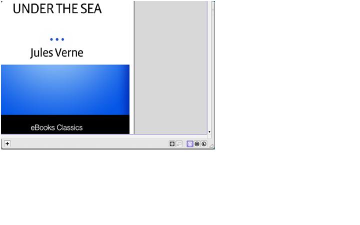

Hi I'm new to this forum and need help with an annoying problem with the eBook Library software.
I've owned the PRS-505 since just after its launch in the UK on the 4th Sept. The e-book library software was working fine until a week ago. I'm running the Library software on a HP Windows Vista Home Premium PC.
The problem started when I bought and downloaded a new e-book from Waterstone's eBook store. Adobe Digital Editions opened automatically and told me I had to install a newer version before I could continue. This installed, started up, and successfully downloaded the new e-book. I copied the e-book from the Adobe Digital Editions library to the connected Sony Reader. I then started the Sony eBook Library software so I could copy the purchased e-book from the Sony Reader to the library to keep it in sync.
When the library software started I noticed it wasn't displaying correctly. Normally in the library window the narrow left hand pane displays the Source View including the Sony Reader if connected. The larger right hand pane displays the headings Title, Author, Size and Date. What I was seeing was no left land narrow pane at all and no Title heading in the right pane. In fact the Author, Size and Date headings were all that was displayed, Author was displayed as 'uthor' and right up against the left side of the eBook Library window.
I uninstalled and re-installed the software. There was no difference. I then uninstalled the software again and because Sony doesn't clean up after itself properly, I manually deleted the following folders in an attempt to totally remove the software:
AppData/Local/Sony Corporation
Program Files/Sony/Reader
I re-booted the system and re-installed the software. Again no difference. In my view that means there are still bits of the software or control files somewhere on my system which the Sony uninstall is not removing.

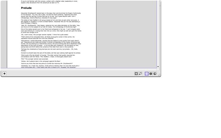

After fiddling around with the software I managed to open an e-book, that doesn’t display correctly, now I can’t get back to the library view. I’ve contacted Sony support but they don’t know what the problem is, all they suggested is to re-install Vista. I’d rather not do that just yet. I've attached screen shots of what I see when I open the eBook Library.
Has anyone seen this before? Any help or suggestions would be appreciated.

Thanks for your reply.
Unfortunatly there is no left pane displayed, it's a though the whole display has been shited to the left, pushing the left pane out of the display window.
I'm not sure how to insert a screen shot into this message, so I've attached a PDF with a couple of shots.
A very odd situation.

Hi, Thanks for your replies.
When I maximise the screen I just get a larger version of the same window, it’s as though the whatever controls the display of the eBook library window has shifter the displayed image to left. No other program is affected by this, just the Sony Library software. I’ve also uninstalled the software, deleted the ..\AppData\Local\Sony Corporation folder (there is no ..\Local Settings\application data\kinoma forlder, I running Vista), re-booted re-installed, but it’s just the same. It’s aso though there is something left of the software sill on my system.
I may have to restore my PC back factory settings as Sony suggests.

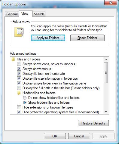

You need to unhide these files using windows explorer.
Go into C: drive and select "organize" then "Folder and Search options" until you get the attached screen.
Then tick of the box to show hidden files.
WDE.

WOW! THANKS! It worked perfectly. Thanks again for your help.
