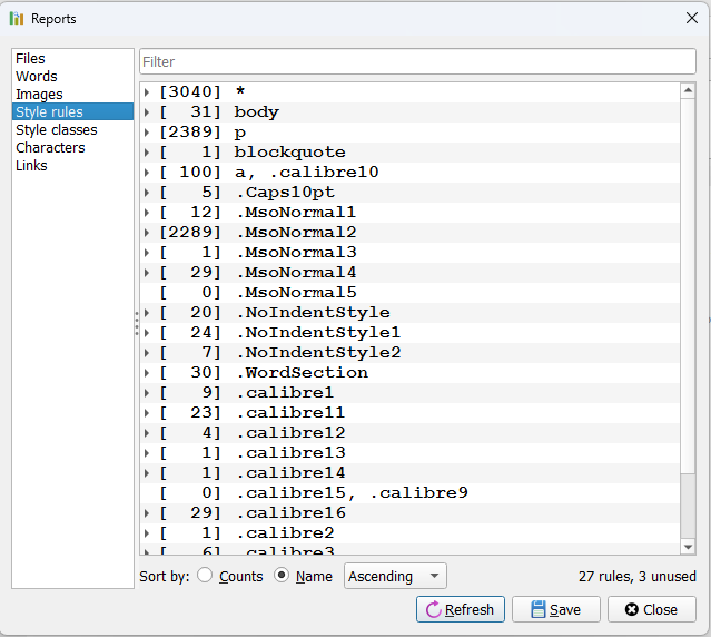

@Kovid: Maybe an addition for the already existing Reports function (Editor>Tools>Reports)?
Yea, I already asked for that. Would be nice...
See my link in the second post of this thread.
