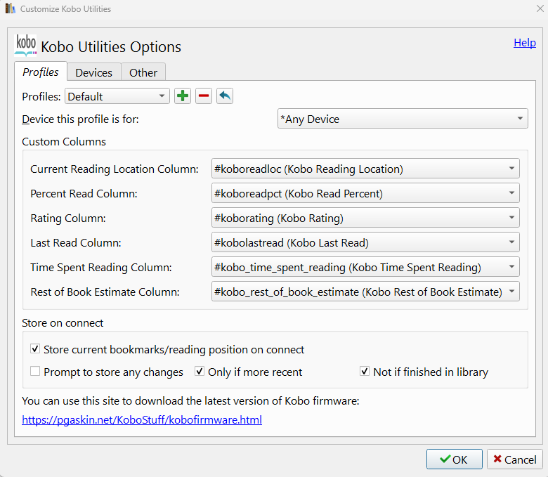

When I connect my Kobo Libra Colour, and the prompt pops up for storing the current reading positions, the numbers listed for the books alternate between silly large ones and the actual %, as shown in the two screen snips below.
My worry is, if I needed to do some restores and Calibre/Kobo Utilities was holding those higher numbers at the time, it will not set my reading % on the Kobo back to where I actually was.

Could you post your custom columns and the templates used to create them. I would suspect that is where your issues are coming from. At a wild eyed guess, the column you have listed as current % is actually holding the reading time in seconds.

Thank you so much - you hit the nail soundly on the head. I had the same column for both reading% and time spent reading;
When I fixed that the problem went away.

For what it may be worth, here's my Kobo reading time columns setup. I've added two custom columns that display the reading time and reading time remaining in hours/minutes instead of seconds.
The templates for the two columns are:
program:
total = $#kobo_time_spent_reading;
hours = floor(total/3600);
minutes = round((total-hours*3600)/60);
def format(v, str):
    if v == 0 then return '' fi;
    return v & ' ' & str & ' '
fed;
format(hours, 'hr') & format(minutes, 'min')
program:
total = $#kobo_rest_of_book_estimate;
def format(v, str):
fed;
