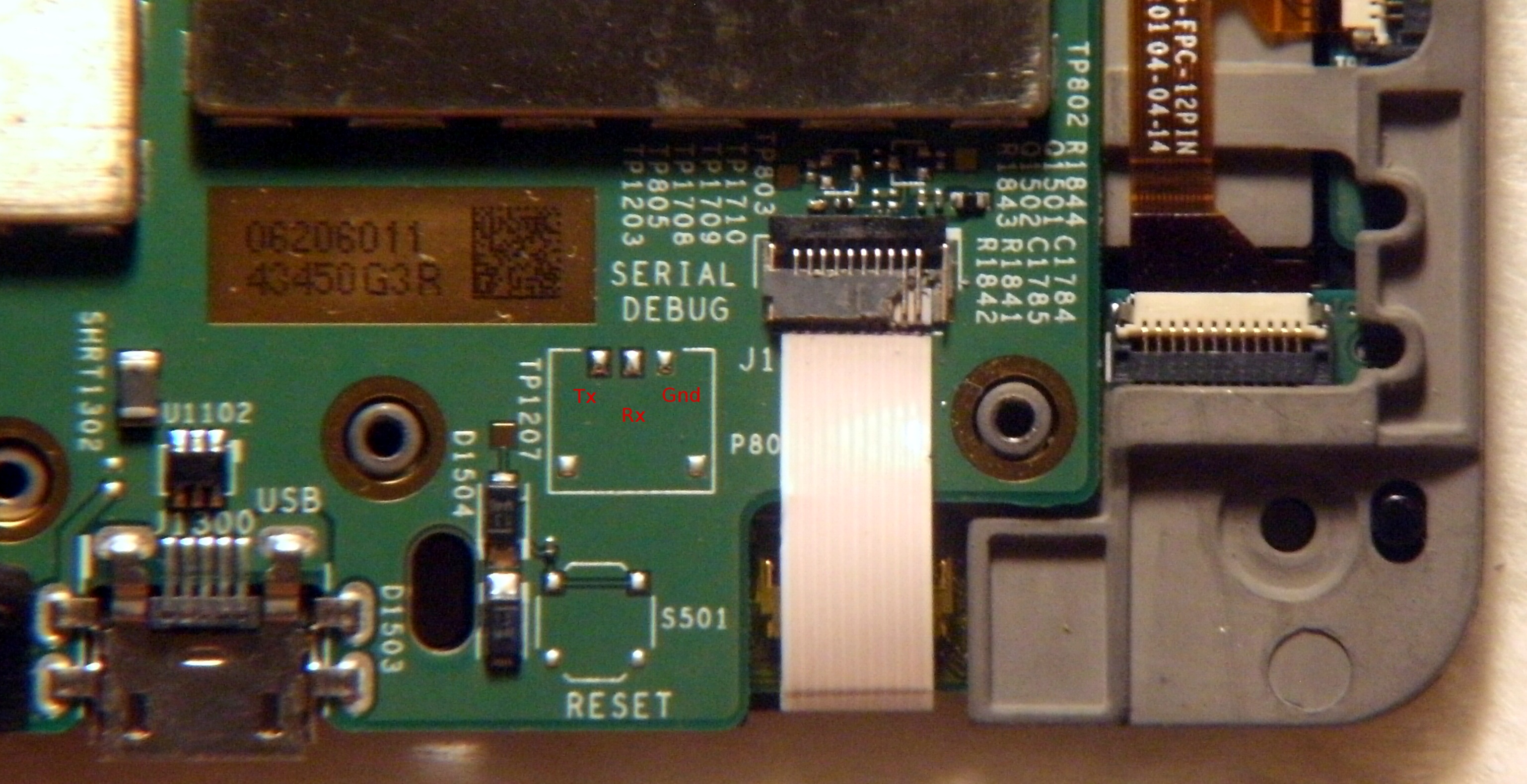

U1102 Identification
I have not been able to identify this part.
Tried both visible light and strong UV light.
Did check a few semi-conductor catalogs for a six pin device with D- and D+ run to those pins, without any luck.
Which just means that I couldn't find it, not that it isn't in someones catalog.
What I did not check was application notes from Freescale.
They might have something with recommended parts to use on the OTG port.

One possibility of a six lead device, very close to the USB connector -
ESD protection - such as:
http://www.mouser.com/ds/2/302/PUSB2X4Y-527574.pdf

Looking to replace U1102
Hi knc1, did you finally figure out what the part is? Thanks!

Looks like ESD5V3U4RRS
