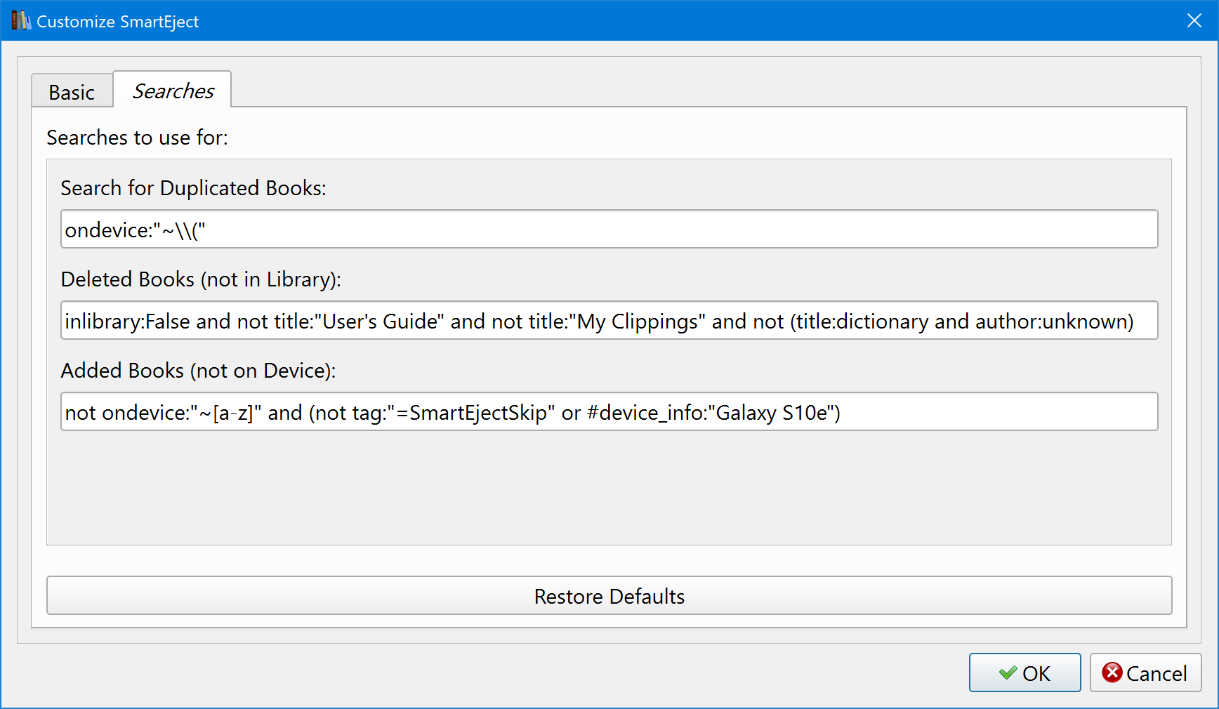

You can configure the searches SmartEject uses. That, along with a specific tag, is how I do it.
Preferences > Plugins (lower left) > Search for 'Eject' > Double click or click Customize button
The actual search strings are on the 'Searches' tab. These are mine, for example:

I saw that but I didn't know how to edit a string.
E: nm. I figured it out. I am the the author of those text files, so I just added "and not (author:me) to the Added Books search string.
