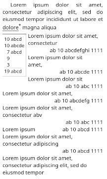

Hi,
I read my epubs on a Kobo Aura H2O and write them as a hobby. I use Sigil and Caliber to edit them.
Here is the result I get on both Sigil and Caliber: when I stretch the text, it is correctly redisplayed:
On my Kobo, the lines overlap...
If I sideload the file in kepub, the behavior is correct... but then I have problems with the notes (styles not rendered in popups).
Should render like this:
I know Calibre/Sigil and Kobo don't use the same rendering engine (webkit vs adobe rmsdk).
I would like to create an epub that behaves correctly on all platforms (probably a dream....)
Is it possible to adapt my xhtml and css codes to achieve this goal for this particular epub?
I attached the test.epub file. Maybe you can test it on another platform ?
Thank you for your advice,
Patrick

Hi,
In landscape mode? Because in portrait is impossible that lines are not overlapped.
Your epub has many errors; maybe if you first fix them, things work fine in your Kobo Aura.
Try fixing the errors because them are in notes.xhtml.
All platforms? What do you mean? Epub2/epub3? Webkit/RMSDK? Legacy ADE (RMSDK) doesn't support epub3. If for all platforms you mean epub2 for Webkit/RMSDK, well, build an epub for RMSDK and what you get, it will work also for webkit. By the way, Kobo has a nice support for epub3 (at least, Kobo for Android and iOS; I don't know if all eink devices have been updated with the last rendering engine).
