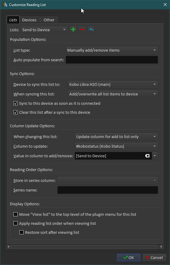

I have an enumerated column, Kobo Status. It has several values: Send to Device, Sideloaded, Fanfiction, and Kobo Store.
Instead of sending books directly to device, I add them to a custom Reading List. The plugin changes the column to 'Send to Device.' This list is synced to the device upon connect.
Name:	2024-01-25 22_26_12-Customize Reading List.png
