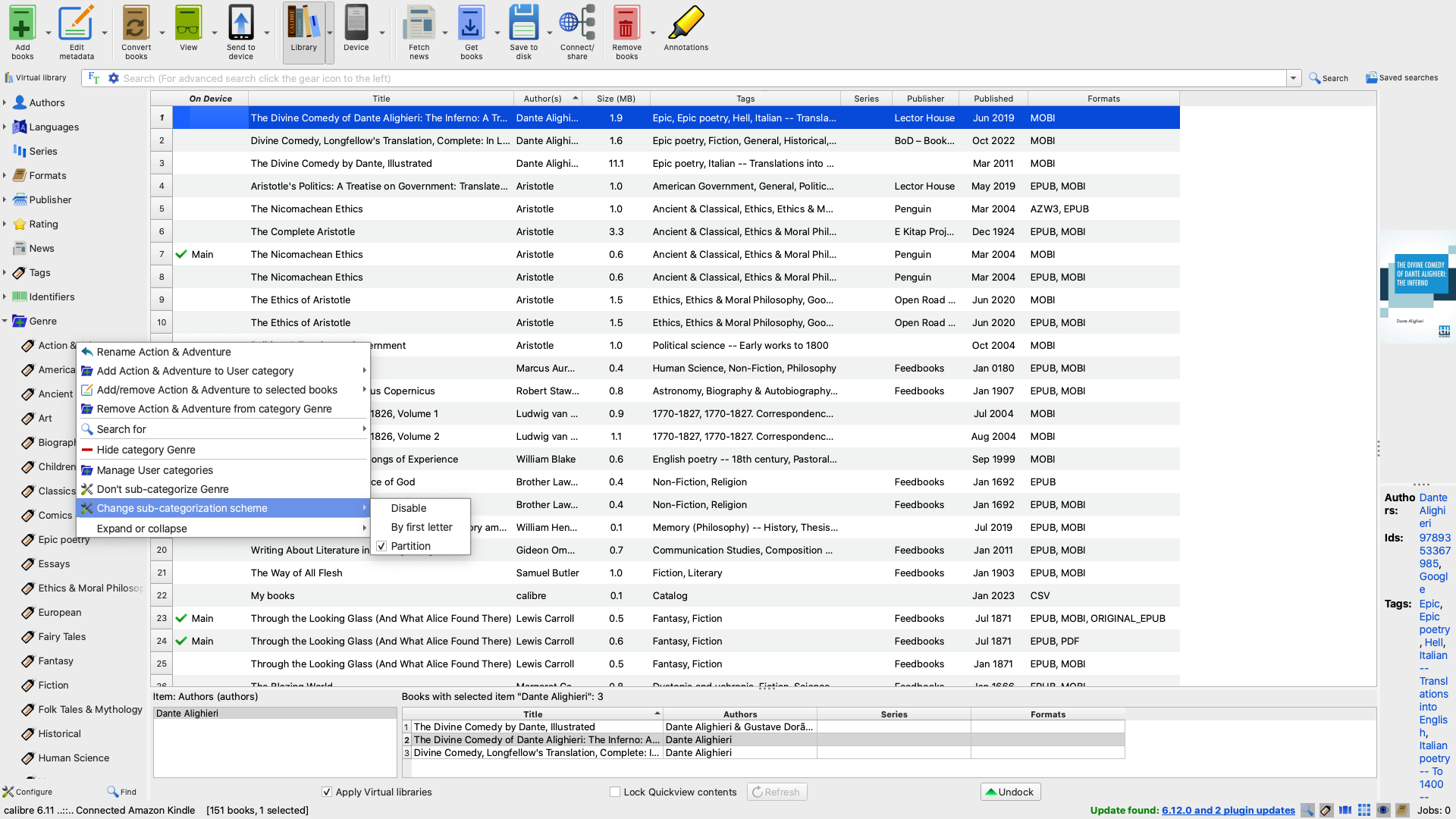

1) Can someone please explain the concept of Polish? How is metadata used to generate more metadata in a way that is different from searching for metadata (and generating it from) online? Also, I continue to get an error message when trying to use the Polish command with Epub and AZW3 ebooks.
2) What happens when separate book records of the same book that is divided into different formats are merged and then exported? Does Calibre make an automated decision about which format to export or is there a dialogue window allowing the user to choose which file type to export?
3) Where is the "Add subcategory" command located? When I right click within the Tags section, I don't see any such option. [I have attached a screenshot to show my view.]
4) I apologize if this is a stigmatizing question (it's not clear to me if this is a file management question that is being explicitly addressed in the FAQs section), but is it possible to change the default location of the Calibre library to an external drive? (I am concerned about running out of space on my computer.) Or does this qualify as tampering with the program's innate coding?

3)I think this is Preferences: Look & Feel: Partitioning... (a tab). The menu allows it to be 'excepted'

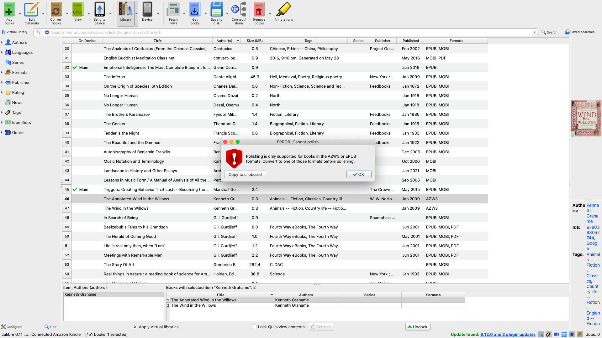

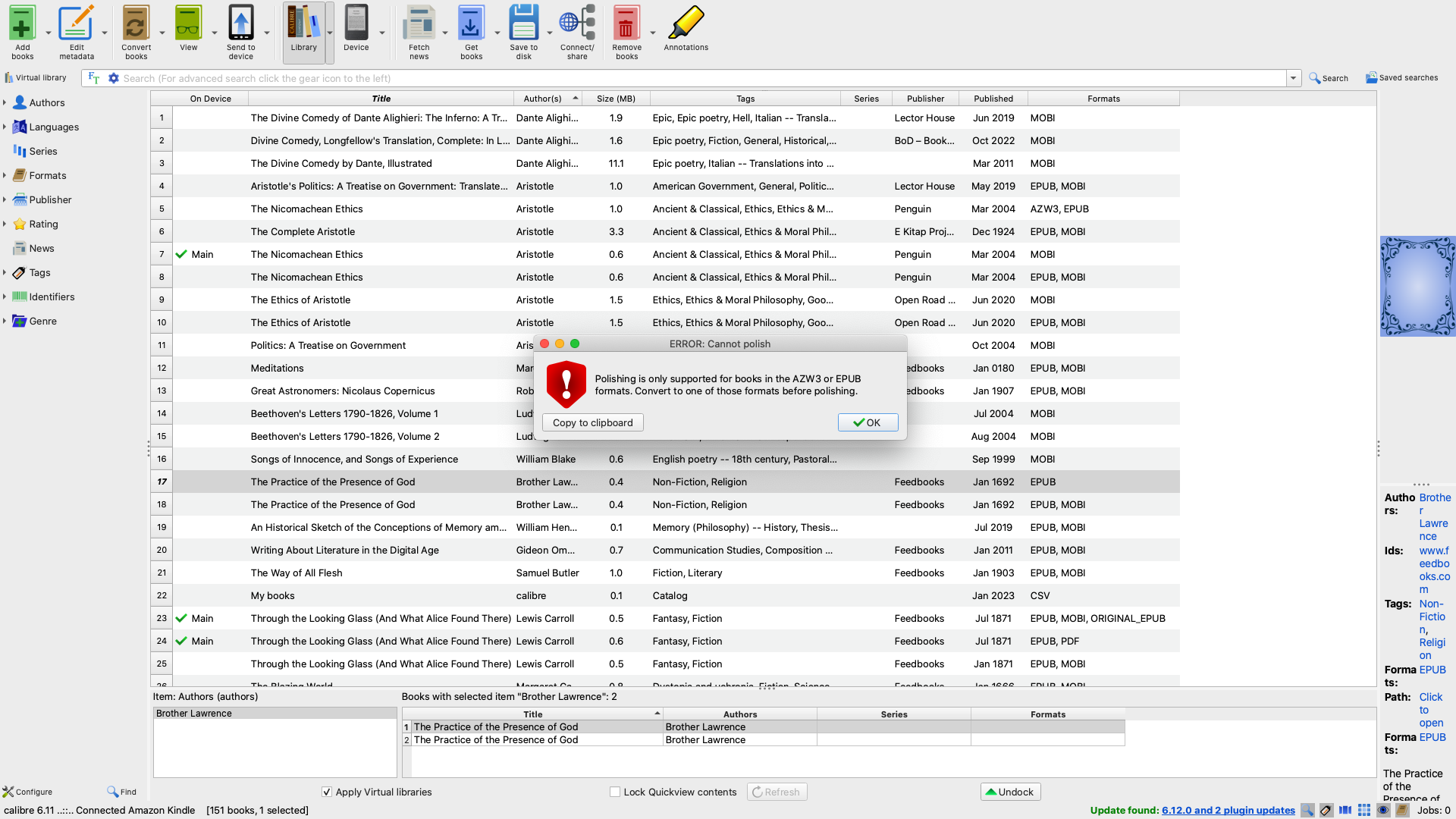

1) post screenshot of options used for Polish books and the error message - there should be a copy to clipboard option.

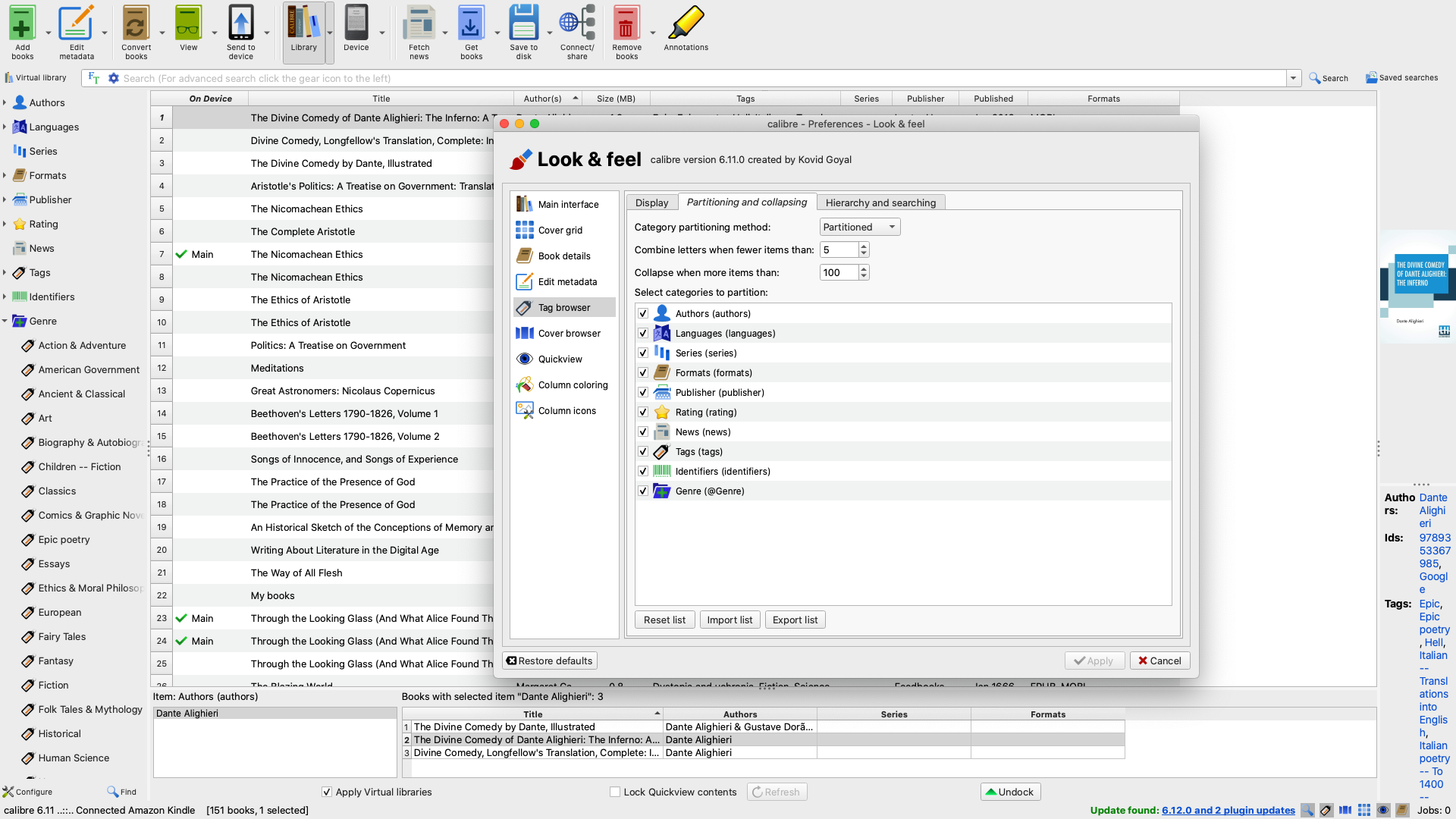

3) I'm definitely still confused on this issue. I have attached some screenshots showing the displayed options within settings as well as the right-click options within the Genre tags section in the sidebar. Does "partitioning" refer to the changes in subcategorization within the file hierarchy (genres: non-fiction: science, history, etc.)? What does the "excepted" setting do? And when would it be helpful to change the subcategorization theme? (Would the latter command help me set up deeper tiers within the Genre tags section?) [I have attached shots of the views I am seeing within Preferences as well as the sidebar.]
4) Am I right in assuming that if I move the default location for the Calibre library, I can rename it whatever and place it wherever I'd like? Is there a best practice to adhere to other than locking the drive?

Partitioning is usually when there is a lot of Values in a column:
Like Authors that last names begin with M (I have 264. Q has 6)
Excepted just means Don't do it for this field
IMHO Partitioning Languages? how many? Would what you have make the list of those LONG? I know many members are poly lingual, but I would be surprised if their Library had 10
Polish only works on books that have (computer readable)metadata embedded. That is what the message is trying to say.
What you see is SAVED METADATA (in the old days, that would be the Card Catalog). Every line is linked to a (set) of formats for A BOOK. Some people do NOT want to embed as that leave the original, as published. Your choice.

Don't over think this. You can change partitioning without a major upset. It is a Presentation setting.
IMHO do worry a bit about planning custom metadata, tags. Those are a lot of work to go back and redo.

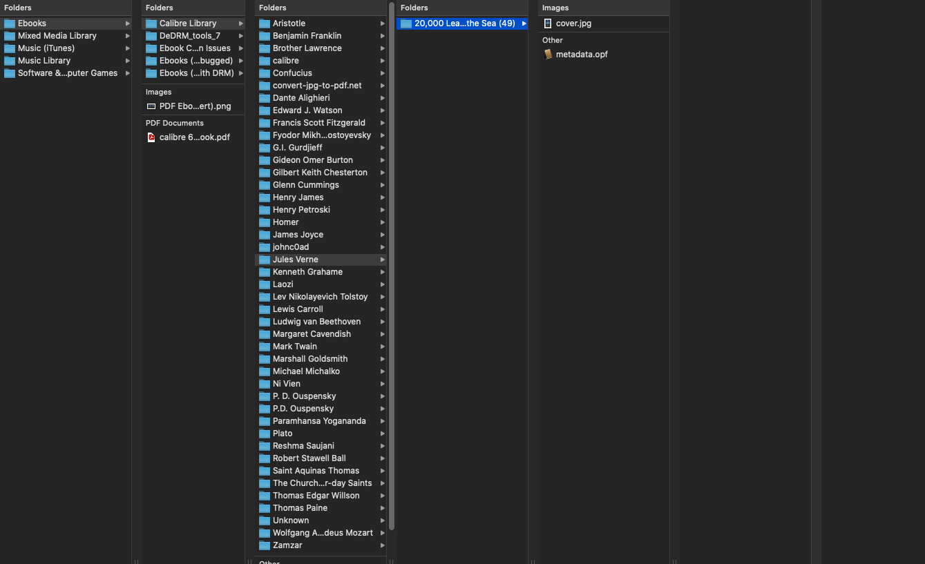

I have moved the Calibre library to my external drive, however, it appears that the actual ebooks themselves have not been migrated. Is there a specific command to migrate the ebooks in addition to the Calibre data? [I have attached a screenshot displaying my view.]

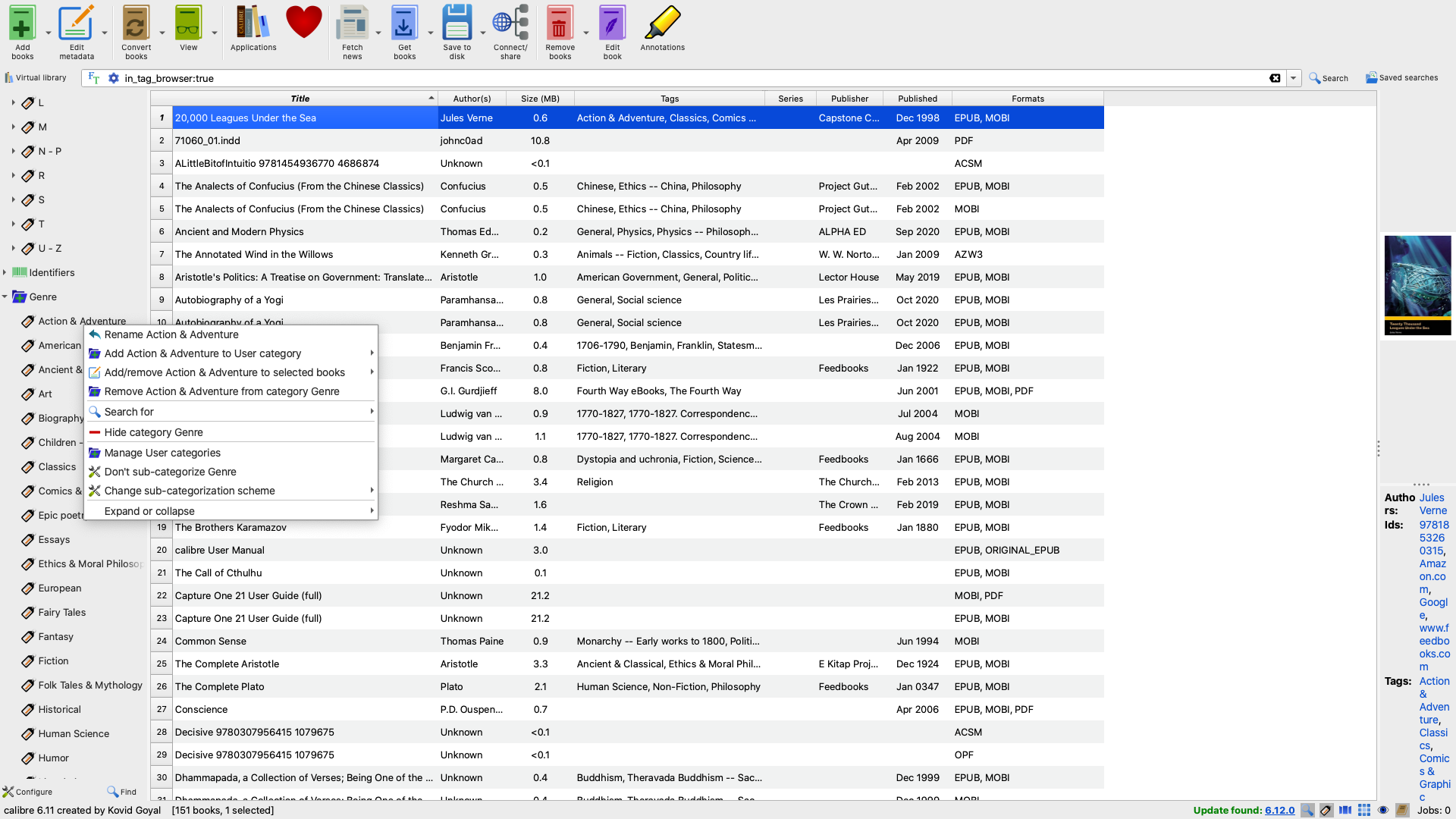

Regarding the creation of sub-categories within customized tag sections (like what I am trying to do for book genres), it still is not clear to me how this is done. I don't see an explicit Create Sub-category button (or any equivalent). I would still like to add telescoping fields within the tags section, if that is possible (again: Non-fiction --> Science (Geology, Physics, etc.), History (-->20th Century, Medieval, etc.). What am I missing?

Books (title folders) are Inside Authors folders
Those contain formats.

I am still not following. Why wouldn't I be able to see the ebooks visibly? I do see some ebooks in some folders; but the files corresponding with the ebooks appear seemingly inconsistently within the Calibre file management library.

If you don't SEE the standard arrangement, it is probably:
1) someone was messing below the skirts and change something. AKA Damaged (Library Maintenance should help identify) Treat the entire structure as a black box. Only Calibre is to make changes.
2) The Library is on A network Share or Cloud/NAS. It only take 2 connections to the same Library to mess it up. Also file Timing MUST remain in lock step. Delays are not good.
3) What you are looking FOR, is not what is in the Library as expected. Something about thee is different. Quality Check Plugin and Find Duplicate Plugin are the easiest way to locate these issues.

If you are trying to set up sub-categories do the following an see if it creates what you want.
Create the Category and sub-category by adding an entry containing both names seperated by a dot.
Non-fiction.Science.Geology
Non-fiction.Science.Physics
Non-fiction.History.20th Century
Non-fiction.History.Medieval
