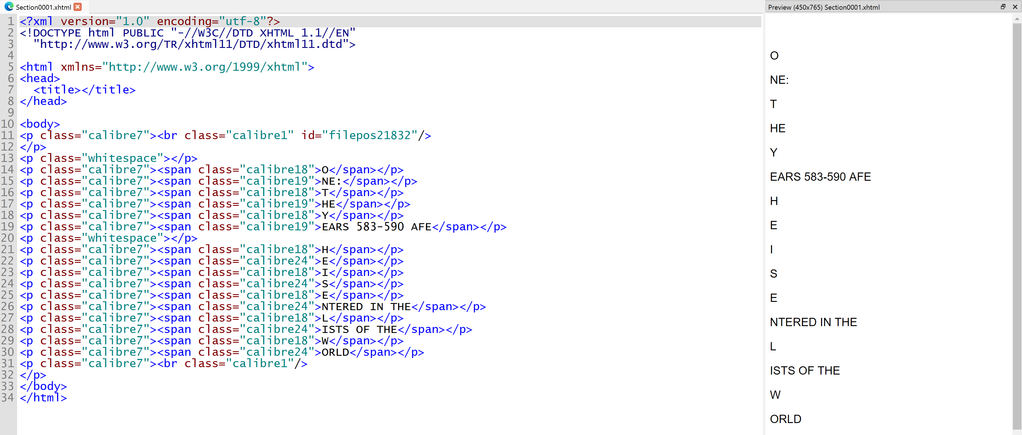

I'd appreciate any help in how to go about reformatting the chapter headings in this book. It's Glen Cook's "A Cruel Wind":
https://www.amazon.com/gp/product/B0...w_myk_ro_title
This is a fresh download of the AZW3 from my Amazon library. What I'm showing here is from my Calibre converted epub, but I've checked the source AZW3 and KindleUnpack versions and they look pretty much the same. Here's an example of what all the chapter headers look like:
<p class="calibre7"><br class="calibre1" id="filepos21832"/>
</p>
  <p class="whitespace"></p>
  <p class="calibre7"><span class="calibre18">O</span></p>
  <p class="calibre7"><span class="calibre19">NE:</span></p>
  <p class="calibre7"><span class="calibre18">T</span></p>
  <p class="calibre7"><span class="calibre19">HE</span></p>
  <p class="calibre7"><span class="calibre18">Y</span></p>
  <p class="calibre7"><span class="calibre19">EARS 583-590 AFE</span></p>
  <p class="calibre7"><span class="calibre18">H</span></p>
  <p class="calibre7"><span class="calibre24">E</span></p>
  <p class="calibre7"><span class="calibre18">I</span></p>
  <p class="calibre7"><span class="calibre24">S</span></p>
  <p class="calibre7"><span class="calibre18">E</span></p>
  <p class="calibre7"><span class="calibre24">NTERED IN THE</span></p>
  <p class="calibre7"><span class="calibre18">L</span></p>
  <p class="calibre7"><span class="calibre24">ISTS OF THE</span></p>
  <p class="calibre7"><span class="calibre18">W</span></p>
  <p class="calibre7"><span class="calibre24">ORLD</span></p>
  <p class="calibre7"><br class="calibre1"/>
</p>
I'm at a loss for how to convert that to something readable. The spans basically work out to be bold tags and the calibre7 class is nothing but a standard paragraph with top/bottom margins of 1em. The problem is even if I remove those, I'm left with all those hard returns and spaces. I can also get rid of the hard returns. But I can't come up with a way or removing the spaces reasonably across all the chapter heading in the book.

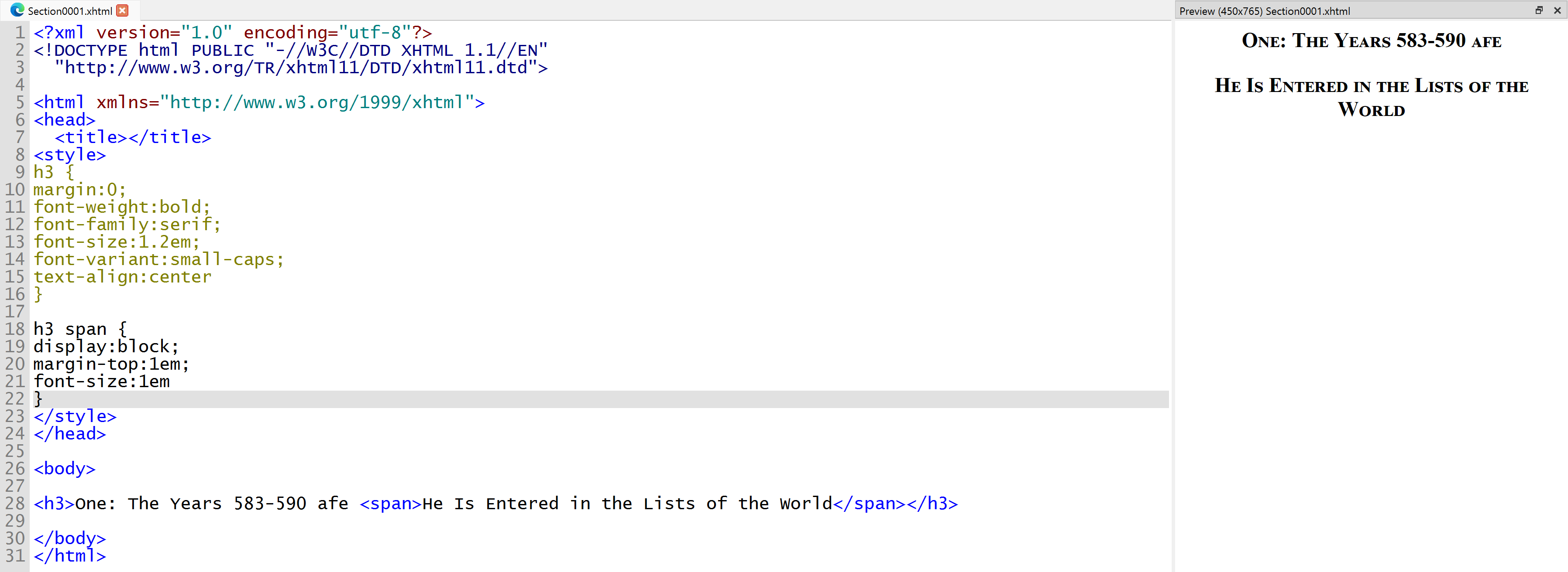

<h3>One: The Years 583-590 afe <span>He Is Entered in the Lists of the World</span></h3>
Then you can style it however you wish. I like using the actual small-caps style as most modern devices respect it; IIRC kobo does. My CSS would look like this:
h3 {
margin:0;
font-weight:bold;
font-family:serif;
font-size:1.2em;
font-variant:small-caps;
text-align:center
h3 span {
display:block;
margin-top:1em;
font-size:1em

EDIT: Regex Confirmed - with only a small edit on pass 2. I've also attached a screenshot of how it would look.

I think I understand what you're doing with that regex. The only issue is that Calibre doesn't support lower-casing via \L\E. But, I worked around that with the Calibre Editor's Regex-Funtion "Lower-case text" mode. I've got to examine the document a bit more to double-check, but it looks good. Thanks.
  • Pass 1: Removes the extraneous starting bit of the bad chapter heading
  • Pass 2: Grabs the end-of-word fragment, strips the formatting, makes it lower case with \L and \E (Calibre doesn't support that) and marks it as heading level h4
  • Pass 3: Grabs the starting character, strips the formatting and marks it as heading level h3
  • Pass 4: Grabs the end-of-word fragment at the h4 level, strips off everything else, concatenates it with the starting character at the h3 level and ends the result in an ending h3 tag
  • Pass 5: Replaces each chunk of intermediate white space (and tags) with a single space
  • Pass 6: Removes the intervening tags/whitespace/class="whitespace" stuff from between the remaining two strings and puts the second string in a span
  • Pass 7: Removes the extraneous ending bit of the bad chapter heading

I used <h3> and <h4> just to differentiate a lowercase section of words from an uppercase. You could use any string of nonsense letters as long as it isn't used elsewhere in the book. I also pretty much end up using <h3> as my chapter headers most of the time, so that came to mind to use.
The use of <h3> as a chapter designation is absolutely NOT required. You will find some people just use <h1> for every heading... I like the ability to use multi-level ToC, both visually (it looks cool and matches the organization in my brain) and functionally (being able to collapse/expand certain areas), and it is more semantically correct if you have a document with subsections to use the different levels of <h1-6> to denote the subsections. It also follows the standard for accessibility...which is a good thing.
The actual <h> tag used is only a semantic indicator of the 'level' of the heading. You can style the heading to look however you wish.
<h1> Cover
  <h2> Front matter
  <h2> Title
    <h3> Prologue
    <h3> Chapter
    <h3> Chapter
    <h3> Epilogue
  <h2> Back matter
<h1> Back cover (if used)
-- OR --
<h1> Cover
  <h2> Front matter
  <h2> Title
    <h3> Prologue
    <h3> Part or Book
      <h4> Chapter
      <h4> Chapter
      <h4> Chapter
    <h3> Part or Book
      <h4> Chapter
      <h4> Chapter
      <h4> Chapter
    <h3> Epilogue
  <h2> Back matter

  <p><br class="calibre1" id="filepos21832"/></p>
  <p class="calibre9"></p>
  <p><span class="calibre3 bold">O</span><span class="calibre4 bold">NE:</span> <span class="calibre3 bold">T</span><span class="calibre4 bold">HE</span> <span class="calibre3 bold">Y</span><span class="calibre4 bold">EARS 583-590 AFE</span></p>
  <p class="calibre2"></p>
  <p><span class="calibre3 bold">H</span><span class="calibre10 bold">E</span> <span class="calibre3 bold">I</span><span class="calibre10 bold">S</span> <span class="calibre3 bold">E</span><span class="calibre10 bold">NTERED IN THE</span> <span class="calibre3 bold">L</span><span class="calibre10 bold">ISTS OF THE</span> <span class="calibre3 bold">W</span><span class="calibre10 bold">ORLD</span></p>
  <p><br class="calibre1"/></p>
So I really don't see how your copy is so messed up since it's good to go from Amazon.
Now to return the eBook and delete it.
