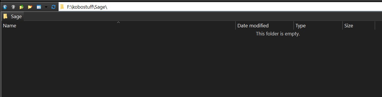

After the informative replies to my earlier question about backups, I configured my Kobo Utilities to backup my Sage daily. The specified folder remained empty. So I changed the setup to "on each connection" and the same result. What am I doing wrong THIS time?

Old 01-04-2024, 12:37 PM   #2
Posts: 31,273
Karma: 61916422
Where is F: ??
Backups should NOT be on the device (look at my config posted earlier. You must create those folders also)
Old 01-04-2024, 12:58 PM   #3
Uncle Robin
Diligent dilettante
Uncle Robin's Avatar
Posts: 3,663
Karma: 52758936
Join Date: Sep 2019
Location: in my mind
Where is F: ??
F is a portable SSD, not the device. That folder already exists, I just cleared it of kobo related stuff to test the backup

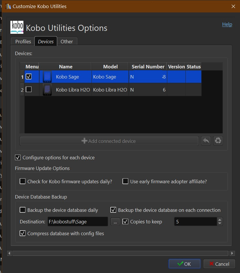

Here is the config screenshot requested. I have just tested it again, still no new files at all in the target folder

Old 01-05-2024, 08:07 PM   #9
Posts: 80,873
Karma: 150249631
Originally Posted by Uncle Robin View Post
The carpet replacement went well, but misplacing the power cable for the ONT meant no internet for much longer than expected.
One thing I do differently is I have the database backed up daily, The reason being is that when you reconnect to update the metadata, the database gets backed up again.

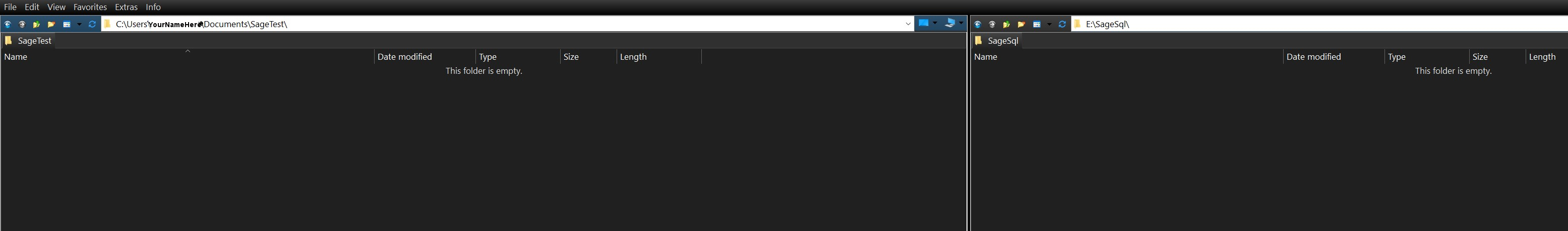

On the off-chance that there was something about that particular SSD that was preventing the creation and saving of the Backup, I created a new directory on another external SSD tried again, then created one in my My Documents (internal SSD) and tried a third time. Results as shown.

Old 01-06-2024, 12:16 AM   #11
Posts: 48,345
Karma: 174315444
I would suggest removing the Kobo Sage and Kobo Libra H2O items in the device list and the configure options for each device checkmark. At times, that list has lost it's connection to the devices after a firmware update, factory reset, whatever.
For me since the backup includes the device information and I use the same configuration for all them, I don't bother with the device list. However if you want to use it, if after removing the device list and the check mark for configure options for each device, try adding your Sage and Libra H2O back in and see if the database backup functions then.
What I meant by device information in the backup is the filename identifies the device and backup date:
KoboReader-KoboSage-N7abcdefghijk-20240105-123537.zip
KoboReader-KoboForma-N7abcdefghijk-20240103-212754.zip
KoboReader-KoboClaraHD-N2abcdefghijk-20240105-115905.zip
Old 01-06-2024, 01:59 AM   #12
Uncle Robin
Diligent dilettante
Posts: 3,663
Karma: 52758936
Join Date: Sep 2019
I
As I mentioned before, there was no such file created. The only backup was the sqliite file I created. So there was no file to have any identifying information in its name.
HOWEVER, your suggestion to disable the "configure for each device" turned out to be the fix.
When I unchecked configure for each device, and connected my Sage, THEN this turned up in the designated folder
KoboReader-KoboSage-N77etc.zip
So, THANK YOU. I don't understand WHY the "configure for each device" setting actually prevents any backup at all from being created, but the why doesn't matter now that I have backup working
