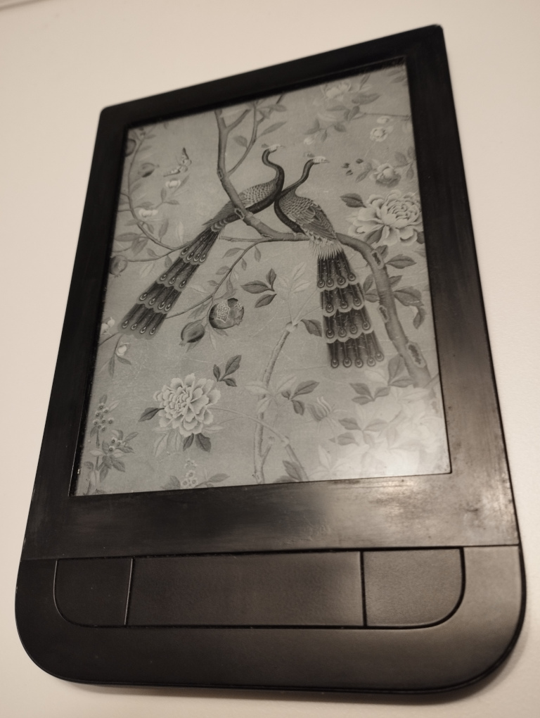

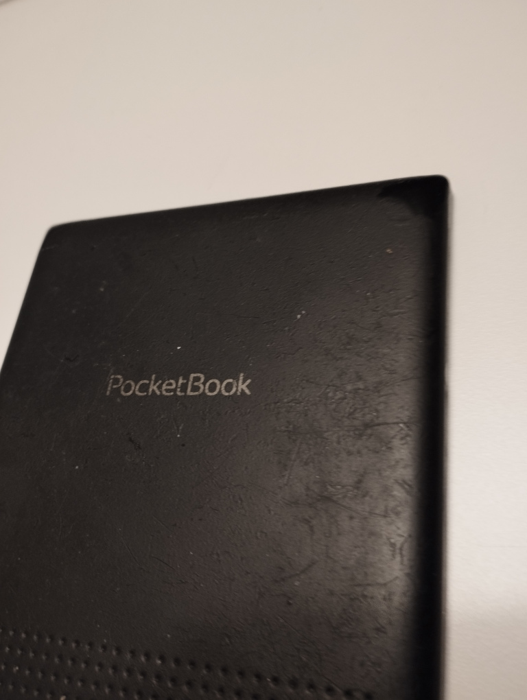

That's mine, front (I could have polished it more) and back (untouched, slightly worn by use, but not at all sticky). No acetone etching, maybe because used diluted acetone. As said, acceptable because black on black. Were there originally decals on the buttons? never mind, better than the sticky mess.
