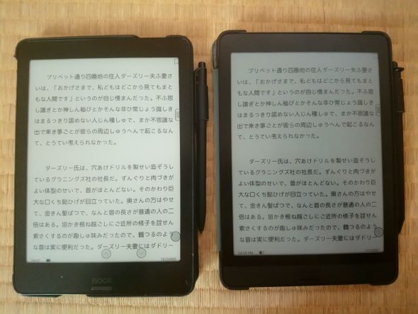

I find the Hisense A5 Pro CC to be very similar to the Nova 3 Color. The screens are significantly darker than a b/w eink device when the fronlt light is off.
I have attached a couple of pictures of the Nova Pro next to the Nova 3 Color. The front light is off on both devices. In each case, it is the very same book on the very same page. The pictures were taken inside on a sunny afternoon without any artificial light being used in the room. The first picture was taken with a "night view" setting enabled. The second picture was taken with just a regular setting and is a bit blurred.
For some reason, although you can see that it is darker, the N3C does not show up as dark as it is in reality. I could read quite comfortably with the Nova Pro in such lighting. It would be a bit of a strain to read on the N3C without using the front light in such circumstances.
