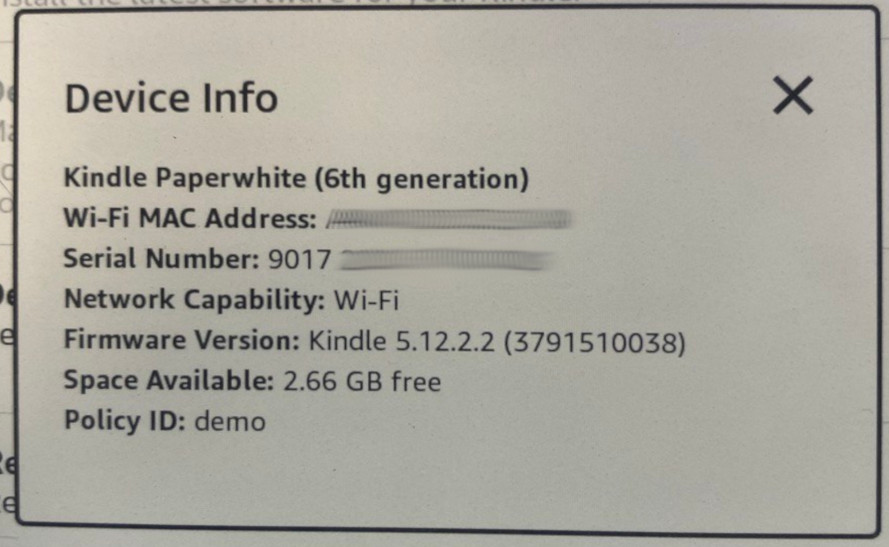

The beginning of the history starts with a mismatch between the hardware on my hands and the AMZ profile.
While the Device Info shows a 6th generation device, Serial No. 9017xxxxxxxxxx, Firmware Kindle 5-12.2.2, my Device profile reports a Paperwhite 10th generation, Serial No. G000Pxxxxxxxxxx requiring a Firmware Kindle 5-18.1

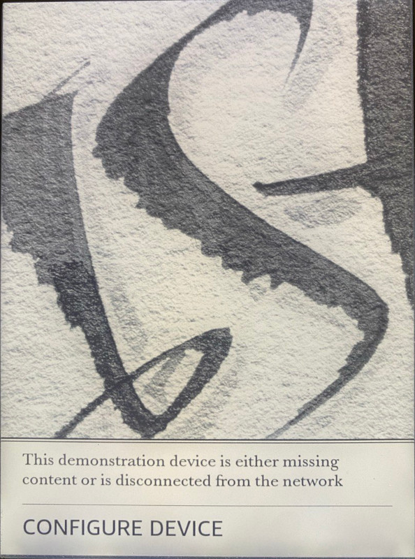

At boot, the kindle was stuck on the DEVICE CONFIGURE menu.
Needed several attempt of magic swiping in order to access to the Sideload Content, as there is no other ways to handle the kindle memory.

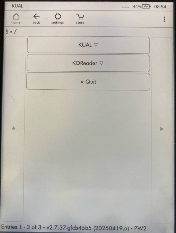

After having installed KUAL launcher and KOReader, a system reboot went again into the DEVICE CONFIGURE menu. No way to exit from that menu.

Magic gesture should still work?
Did you try "force reboot" by pressing and holding power button for 15-20s?
Just to double-check: you know that "magic gesture" equals 2 finger tap + SINGLE finger swype (to the left?
What happens when you connect that Kindle to a computer using USB cable? (while it's stuck on that screensaver). Is Kindle visible as remote storage?
I thought there was no other ways to do this magic swipe... the point is that by repeating the same "2 finger tap + 1 finger swipe" procedure, sometime works... quite often nope!
I don't know why.
The kindle became visible as remote storage ONLY by typing the command ;demo in the search bar, then it allows the Sideload Content function from which it can be accessed as storage.
Strange history, I don't know what I have to do for fixing
