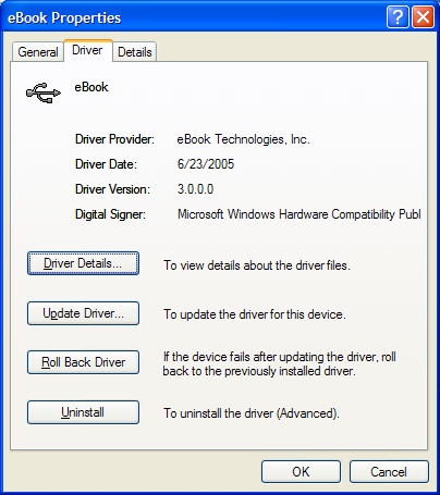

If you see that ebook item, then double-click it to see the Properties and tap the Driver tab (it should then look like "-pic2", below). Ensure you have the right driver, if not, click the Update Driver button. You may also want to tap the Driver Details button to ensure you have the info as in "-pic3" below.

Thank you so much for your help. I installed/reinstalled the driver 2 more times - with no luck - still no signal. I had checked the device driver before - and, again, it showed no problems. I took your advice and installed the driver and impserve on another computer - and the device worked fine - which narrowed the issue down to it being a problem with my laptop. I finally tracked the problem down to a firewall issue (which made no sense, because the driver only stopped working recently and the firewall has always been there) - but when I shut the firewall down and then reinstalled the driver and impserve, and then restarted the firewall, the driver worked. So, the problem is solved - I guess....
