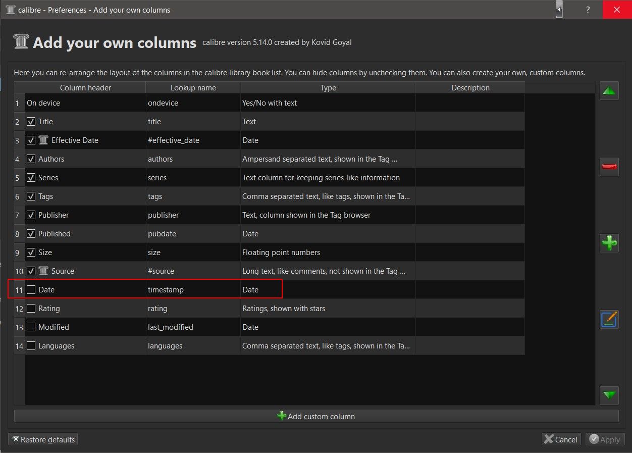

First up, the '#'s are only used on custom columns, standard columns don't need them, i.e. Published/pubdate, Title/title etc.
The column you want is Date/timestamp
Name:	Screenshot 2021-04-16 212621.jpg
But IIRC it isn't available in Bulk Edit Search & Replace, and I don't remember why. But nor do I see how it would help you with your Merge issue.
