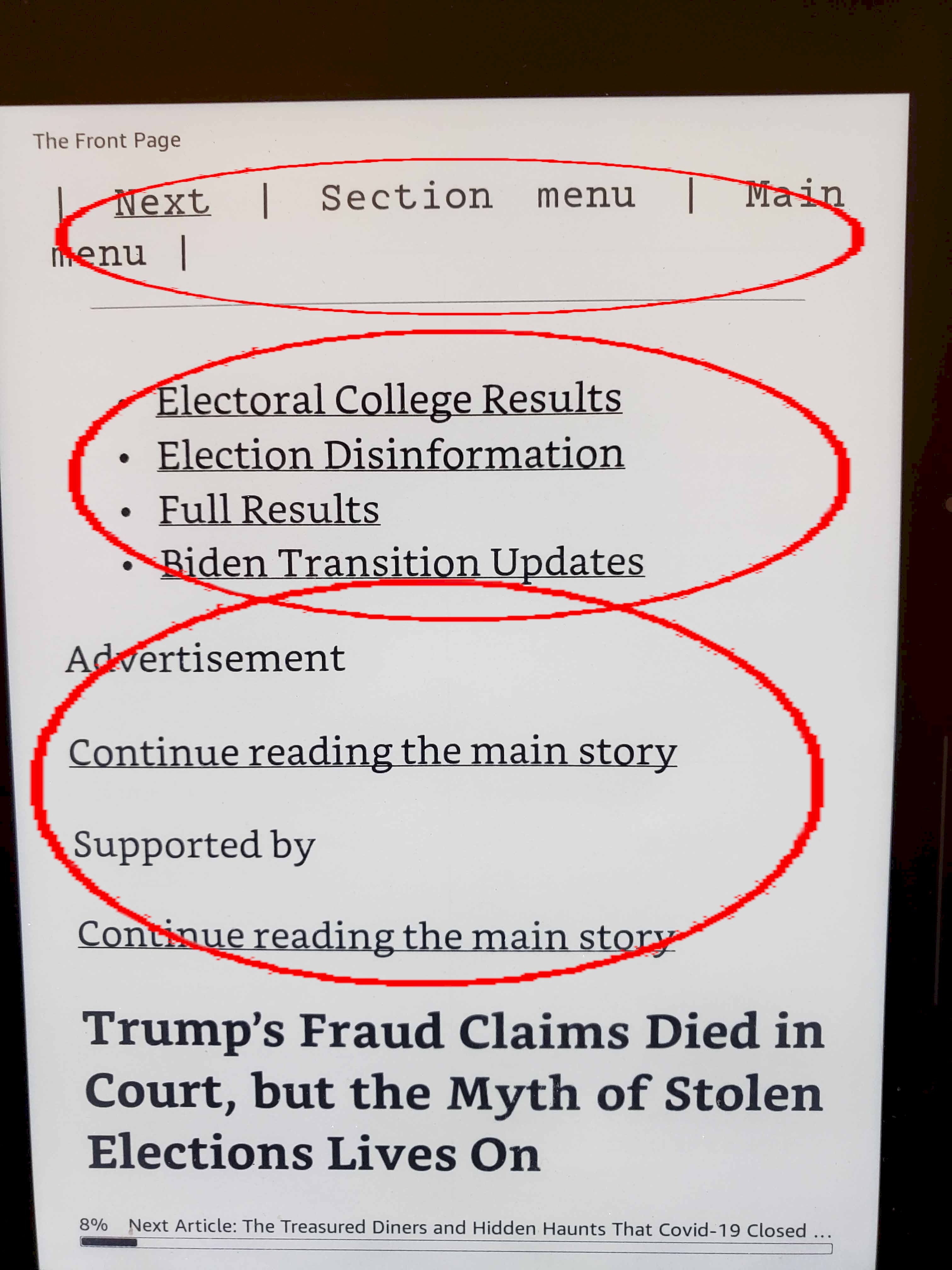

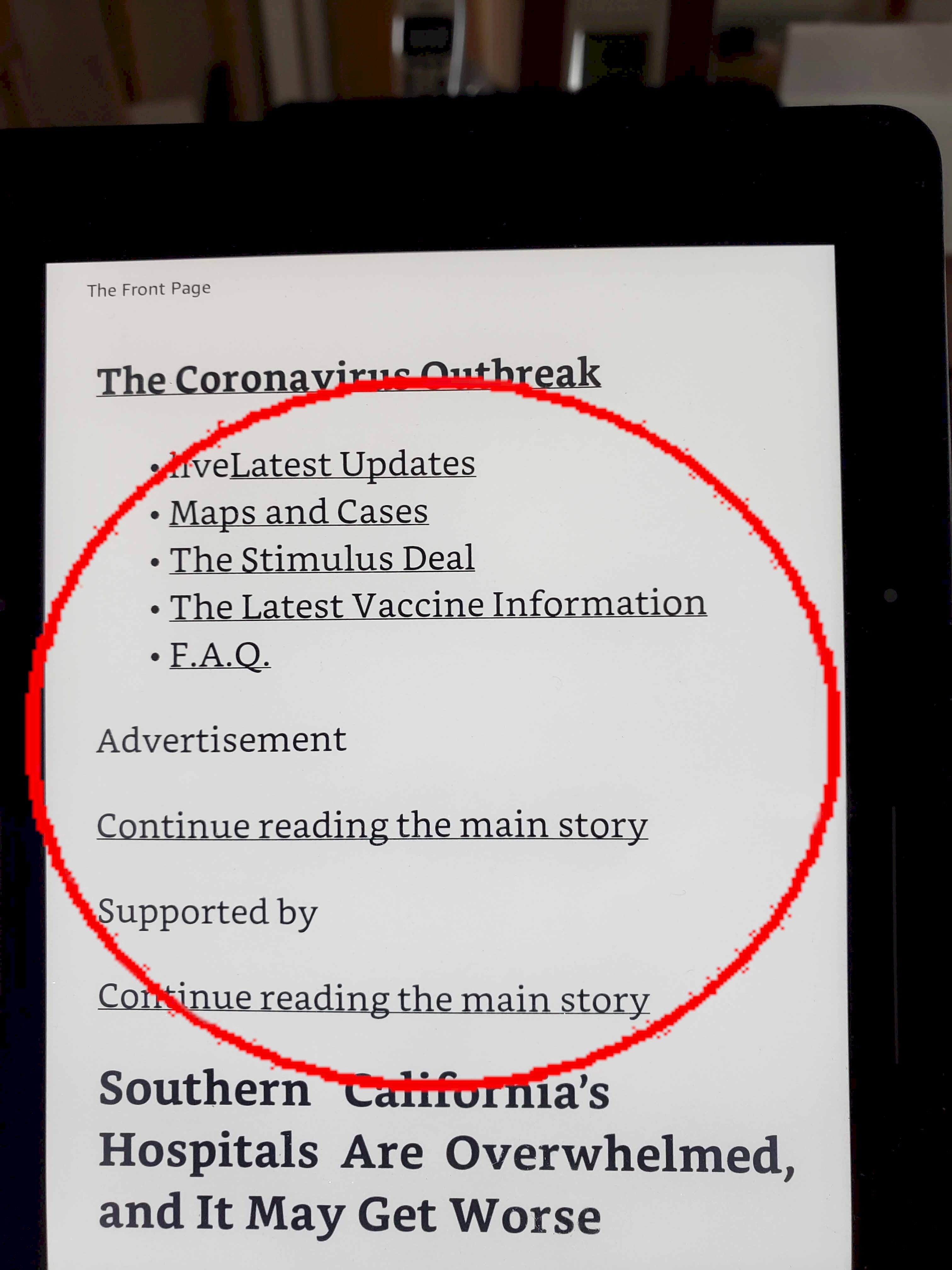

I am having problems with the USA Today recipe for every update since 4.23. There are many extraneous pieces of information appearing since the new updates. I keep going back to 4.23 so I don't get all of the extraneous info. See attached photos.
I am also getting a lot of extraneous info with the New York Times recipe. The extraneous info is appearing even on 4.23. But the biggest problem with the NYT recipe is that it will not allow me to select what sections I want to download. I have completely removed (as opposed to simply putting a pound sign) all sections I do not want downloaded. Never-the-less, the sections still download. As examples: I have removed Arts, Books, Sports, Home, Obituaries and others from the recipe but they all still download.

Thank you for taking the time to reply. Your suggestion to use the web edition of the NYT worked to allow me to remove sections from the recipe that I did not want to load onto my devise. Unfortunately, when I updated Calibre from 4.23 to 5.8.1, I still got all of the extraneous information I previously complained about. I am trying again to upload pictures but I did not have much success the last time. I hope you can assist me further.

One more attempt to upload images describing the extraneous infobeing loaded with the recipes for USA Today and The NYT.

The next and previous links at the top are because you dont have a kindle output profile set. As for the related and continue reading links, I dont get them with the builtin recipe.
