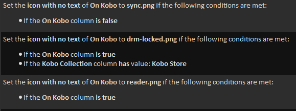

Here are the three rules I was trying to replace:
Name:	2020-12-25 20_59_46-Window.png
What I was trying to do, using boolean search syntax in place of the template:
if #onkobo:no, then 'sync.png'
else
if #onkobo:yes, then
   if #kobocoll:"=Kobo Store" then 'drm-locked.png'
   else 'reader.png'
Even with the missing fi added, I messed up the template a bit as it instead returns reader.png for everything.
