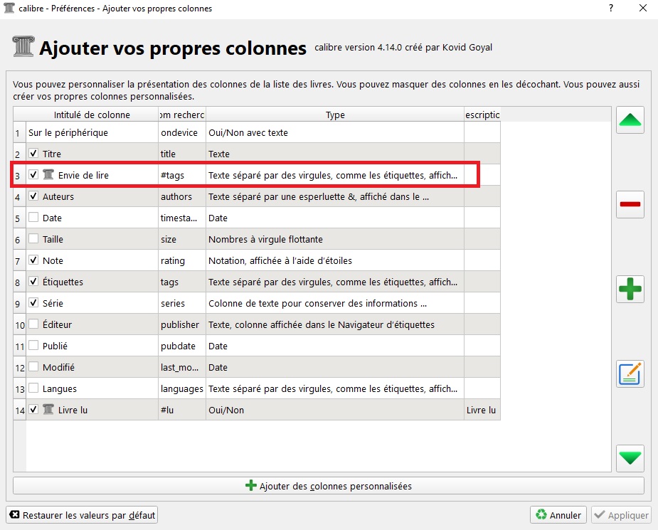

Hereafter the attached file.

Old 04-30-2020, 10:37 AM   #7
Posts: 31,327
Karma: 62025226
Is the lookup name for "Envie de lire", #tags ?
IMHO It may be best to avoid lookup names that are very similar:
tags Vs #tags
Murphy is alive and lurking

davidfor
Posts: 24,905
Karma: 47303824
Location: Sydney, Australia
Hello Davidfor, thanks a lot for your answer and you are right I tried to either copy collections from KOBO to Calibre or from Calibre to Kobo. So it's why I posted 2 messages.
Today, I want only to copy collections from Calibre to Kobo and I follow the post what you gave me : https://wiki.mobileread.com/wiki/Kob...nd_Collections (Finally, I think so...) but I can't find my column "Envie de lire" into my Kobo. Can you please see my attachment to check if what I did is correct. I click OK after to fill it and Calibre was rebooted (Sorry but my Calibre is in french...).
Google tells me that "Envie de lire" means "Want to read". Is that an actual column in your calibre library, or is it a tag? If it is a column, you need to use the lookup name for your column in the driver configuration. As @theducks said, calling a custom column "#tags" is a bad idea. It should work, but sooner or later it will cause confusion.
If "Envie de lire" is a tag in the standard calibre tags column, its lookup name is just "tags". The "#" at the start is used for custom columns.

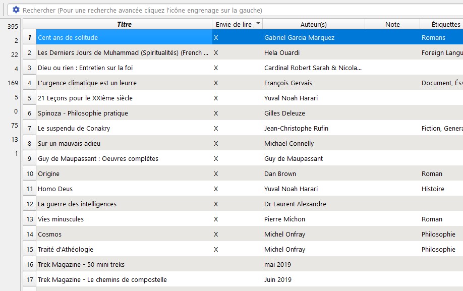

Old 05-01-2020, 05:41 AM   #9
jm2606
jm2606 began at the beginning.
Posts: 13
Join Date: Jan 2018
Location: France
Device: Kindle voyage
Hello theduck and davidfor
Yes "Envie de lire" is the name of my column that I created into calibre as describe in my attachment.
I tried to put either "#tags" or "Envie de lire" into the field of "Colonnes Collections" into the configuration of the kobo (see my previous attachment).
I'm really sure that I miss something but I don't know what....
Thanks a lot for your help.
Jean Marc

Old 05-01-2020, 07:45 AM   #10
davidfor
Posts: 24,905
Karma: 47303824
Firstly, "#tags" is the correct value to use.
But, you shouldn't be looking for "Envie de lire" on the device. The values that are in the column "Envie de lire" should be created for collections if the books are on the device. Go to the collections tab on the device, and they should be listed there.
If they aren't, it might be another option. In the preferences, go to the "Sending books to devices" (on the third row, third from the left). For Metadata management at the top, select the automatic option. This will make sure the metadata, including the collections is done each time the device is connected.
If it is still not working, I'd like to see a debug log. Run calibre in debug mode by right-clicking on the preferences and selecting the option there. Calibre will restart. Then connect the device and let the jobs run. When they are finished, close calibre and the log will be displayed. Post the log, or PM it to me. I can usually see what is wrong from it.

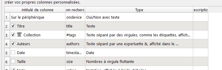

Old 05-02-2020, 05:10 AM   #11
jm2606
Posts: 13
Join Date: Jan 2018
Location: France
Hello Davidfor,
My understanding about synchronization of collections between my device and calibre is this : I create a dedicated column on Calibre (1st and 2nd attachment), I fill it (see my new attachment), if the name of the column into Calibre is not present into my device so Calibre create it, after, I open my device, I go to collection and I see "Envie de lire" and all books where I put "X" on the column of Calibre.
Here is my understanding and maybe I'm wrong...
I change also in automatic mode but no change.
Please let me if my understanding is ok before to send you the log.
Jean Marc
Name:	Annotation 2020-05-02 100900.JPG
jm2606 is offline   Reply With Quote

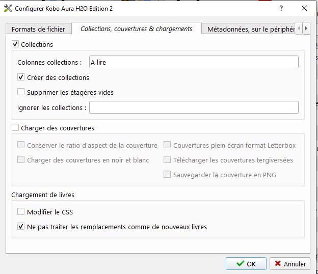

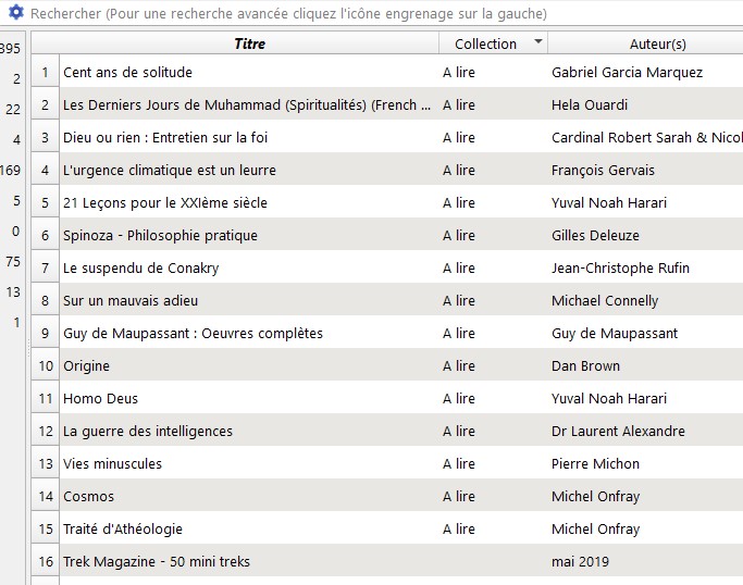

Old 05-03-2020, 04:40 AM   #13

Hello Davidfor, thanks a lot ! now I understood !!!
I put "A lire" as a value into a column named "Collections". I changed into my preference and in configuration. Please see my attachments. But no "A lire" collection into my kobo. I post you in MP my log.
Jean Marc

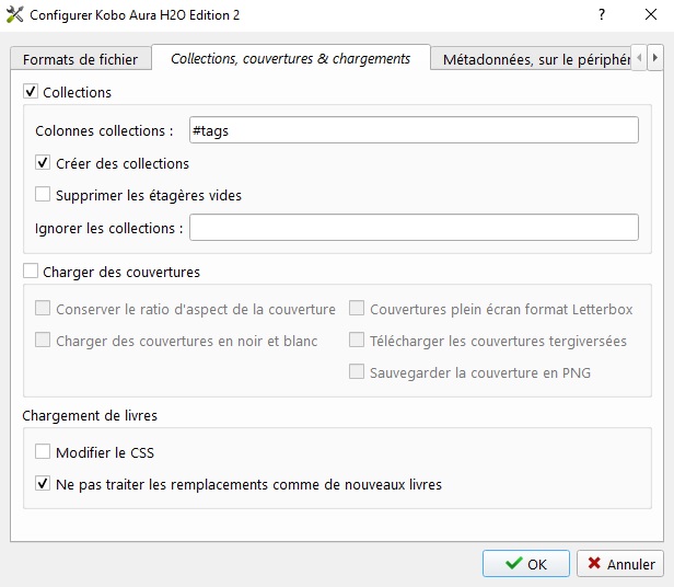

Old 05-03-2020, 07:01 AM   #14
davidfor
Posts: 24,905
Karma: 47303824
Jean Marc
Sorry, but you keep misunderstanding. So, I'll be explicit:
  1. In the driver configuration, but the lookup name of the column. In your case, this is "#tags".
  2. In that column, put the values you want to use as collections. This is probably "A lire". But, could be anything.
  3. Connect the device and let calibre do it's stuff. Make sure at least one book with the value "A lire" in the column is on the device.
  4. Eject the device.
  5. Open the collections list. There should be a collection called "A lire".
  6. Open the "A lire" collection. It should have the books that in calibre has the value "A lire" in the column.
Clear?
Old 05-04-2020, 12:49 PM   #15
jm2606
Posts: 13
Join Date: Jan 2018
Location: France
Hello Davidfor, Thanks !!! now it's clear and working in this direction !!!
I tried to follow your first post to copy collection from my device to Calibre and it's not working... : in fact I do like this :
I created one new collection into my device (the second one),
I put one book in this collection into my device,
I started Calibre,
I connect my device,
I used the function "Get Shelves from Device" of Kobo utilities => I select "#tags" => OK
The result was :
- no creation of my second collection into calibre
- no change on my first collection on my device & calibre ( yes )
- removal on the only one book into my new collection into me device
- My new collection (the second one) is still alive into my device !!!
Thanks again for your help for this step !!!
Jean Marc
