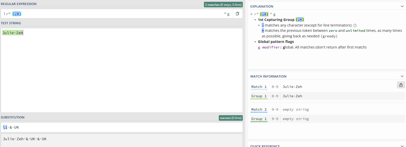

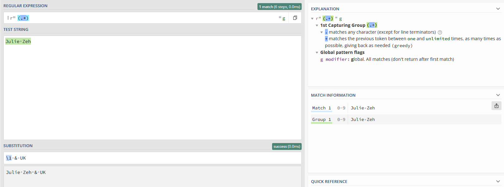

I tried your sample on Regex101.com with Python as the regex variant. See the two screen shots attached. The * matches zero or more characters and returns 2 matches while the + matches 1 or more and returns 1 match.

I remember having a similar problem and filing a bug report about it. Kovid told me it was because of a change of how python3 deals with regex compared to earlier version. Apparently * matches differently than +.
The solution he offered me was to replace .* with .+ and that took care of the problem.
Edit: See the above post by DNSB for explanation of the whey this happens.

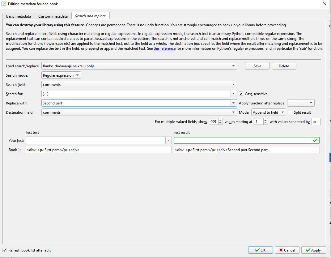

This is the first part of a comment to which I would like to add a second part.
Let's say this is the second part.
After (.+) I get :
Let's say this is the second part. Let's say this is the second part.
For author and title is OK.
Maybe problem is type field Comments ?

I don't fully understand what is happening there. But I think it has to do with comments being multiline, where each line is being matched separately. Try using the (?s) modifier to turn off single line mode:
(?s)(.+)

Yes,yes,yes - super - that's it.
Maybe I'm boring, but let me ask - my second part that adds would actually be the biography of the writer and I would use copy-paste in the field Replace with - could I insert some command at the beginning of the biography so that it is inserted into a new line?
Example:
First part + (some command) Second part (Replace with) and I get:
First part
The second part

I fix with (?s)(.+) in Search for and this in Replace with :
*********<div><p>Second part</p></div>

Instead of: Mode: Append to field | use: Mode: Replace field
Now use back-referencing to include the original text
search: (?s)(.+)
replace: \1\nSome random text you want to insert
\1: reference for the matched part i.e (.+)
