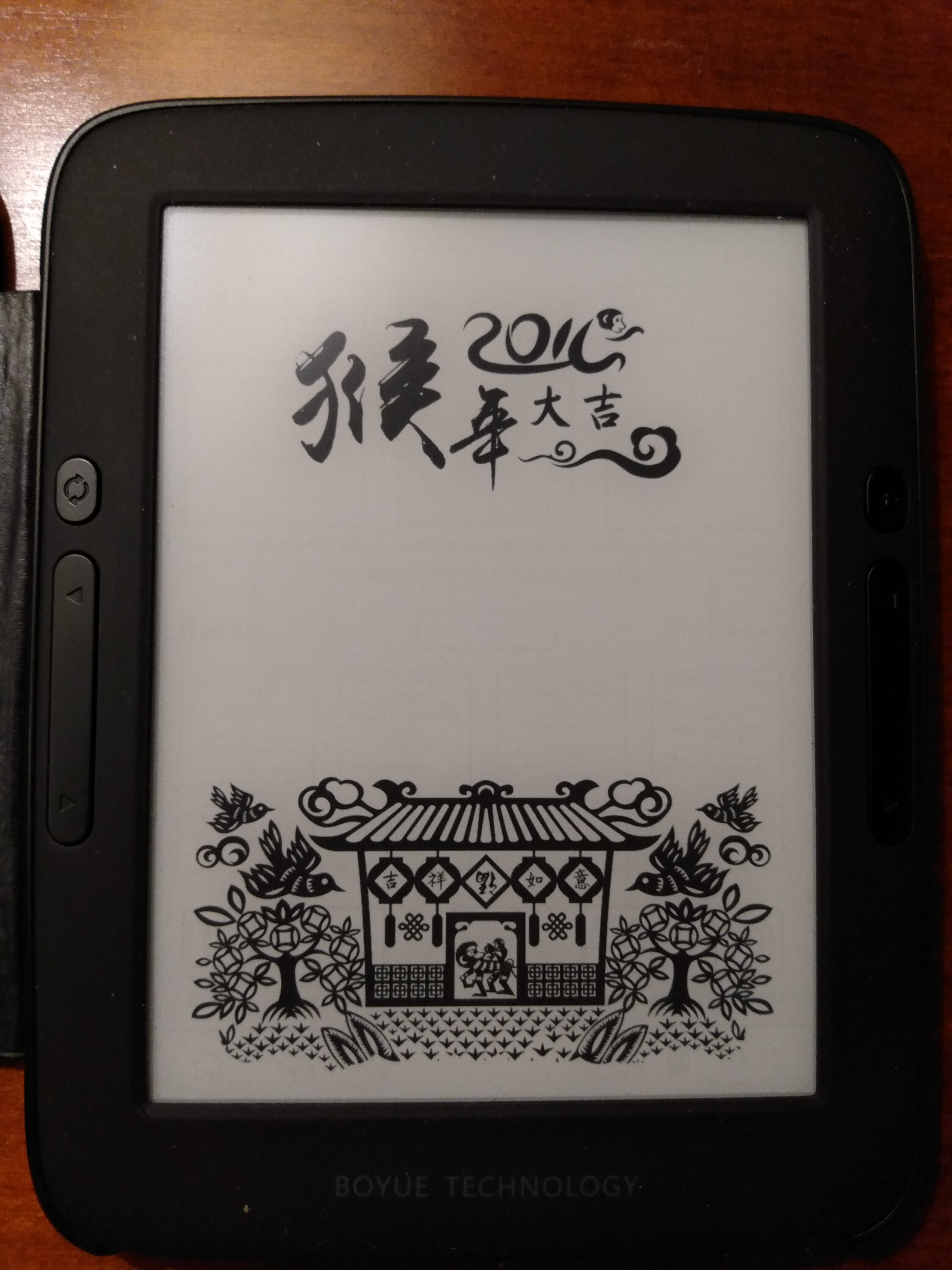

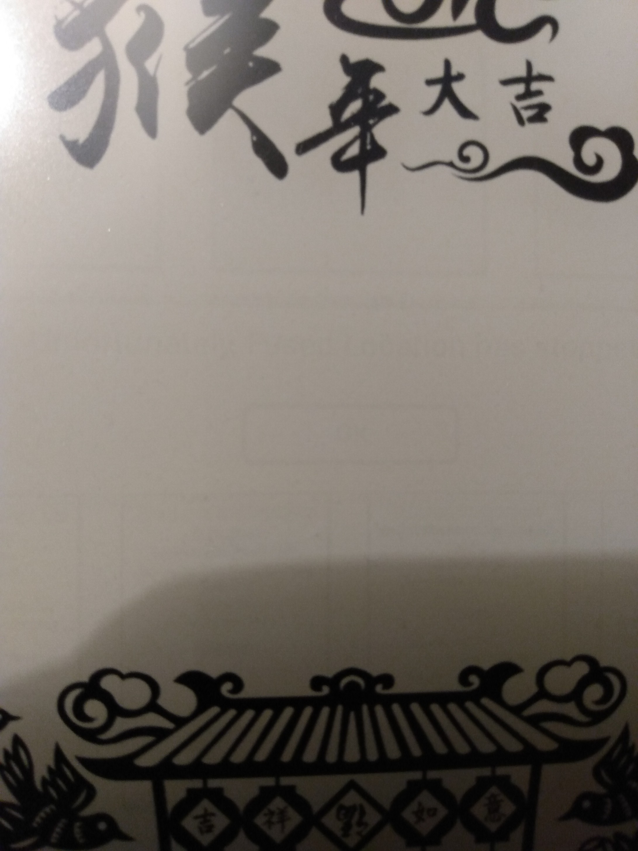

Thanks for your reply!
Here are some pictures I took..

Old 08-05-2019, 10:10 PM   #4
rvcjew
rvcjew ought to be getting tired of karma fortunes by now.rvcjew ought to be getting tired of karma fortunes by now.rvcjew ought to be getting tired of karma fortunes by now.rvcjew ought to be getting tired of karma fortunes by now.rvcjew ought to be getting tired of karma fortunes by now.rvcjew ought to be getting tired of karma fortunes by now.rvcjew ought to be getting tired of karma fortunes by now.rvcjew ought to be getting tired of karma fortunes by now.rvcjew ought to be getting tired of karma fortunes by now.rvcjew ought to be getting tired of karma fortunes by now.rvcjew ought to be getting tired of karma fortunes by now.
rvcjew's Avatar
Posts: 396
Karma: 2157838
Join Date: Nov 2017
Location: USA,CA
Device: PW3-T80S-T80D-T103D-K78-Inkpalm 5-HiSense Touch-Hi Reader Pro-Palma
Have you ever seen that art screen before? Is that the normal boot screen then it goes into the os?
Malcolm
rvcjew is offline   Reply With Quote
Old 08-06-2019, 05:52 AM   #5
5y2SB
5y2SB began at the beginning.
Posts: 17
Join Date: Jul 2016
Yes, the "art screen" is shown when the device is turned off. Take a look at the first picture though and you may see a very fine "watermark".
5y2SB is offline   Reply With Quote

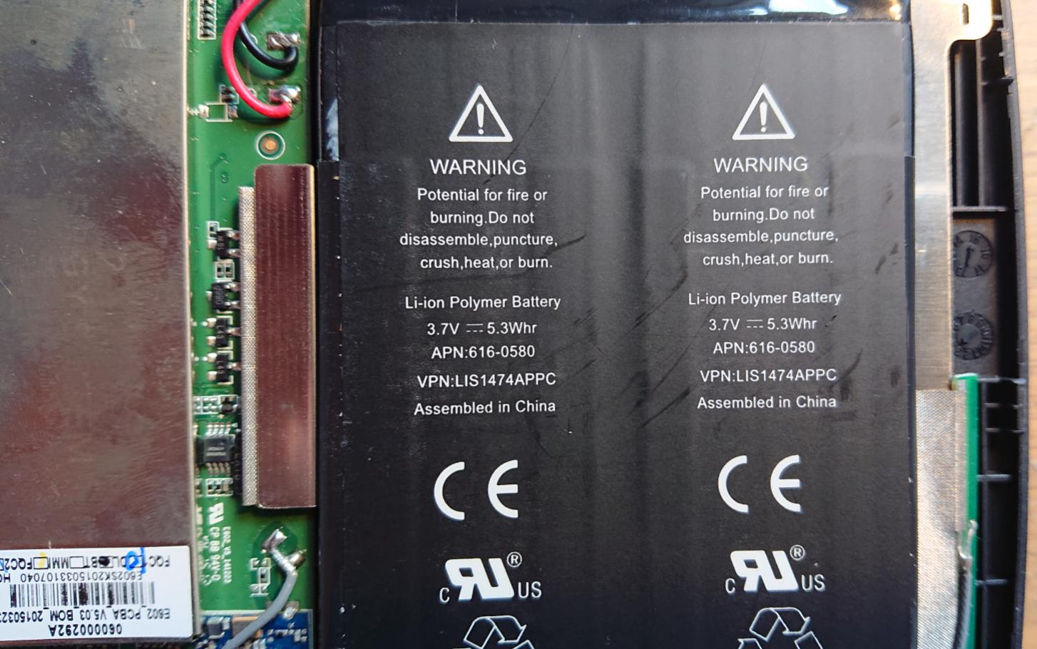

Originally Posted by rvcjew View Post
You could pop off the back cover slowly if you have a spudger and inspect the battery but it is soldered on it seems. I also can't find a replacement for it anywhere. Might be time for a new device. It needs to be opened and the info of the battery written down to source a new one.
Malcolm
This is the view of the interior . Anyone know which batteries might be suitable replacements?
Old 09-04-2019, 03:23 PM   #12
rvcjew
rvcjew's Avatar
Posts: 396
Karma: 2157838
Join Date: Nov 2017
Location: USA,CA
That is a pic of your actual unit that you took right?
Malcolm
Old 09-04-2019, 03:49 PM   #13
5y2SB
Posts: 17
Join Date: Jul 2016
Yes, it is!
Old 09-07-2019, 04:48 AM   #14
rvcjew
rvcjew's Avatar
Posts: 396
Karma: 2157838
Join Date: Nov 2017
Location: USA,CA
Yes, it is!
Would need to get the battery out and then clip its wires and cover with something like electrical tape so they can't short, then source a new one.
Malcolm
Old 01-01-2020, 10:05 AM   #15
DonaldDuck
DonaldDuck began at the beginning.
Join Date: Jan 2020
Device: Energy Sistem Pro+
In my Energy Sistem Pro+ (Boyue T62+) there are two IPhone 4S battery
and they can be bought on AliExpress - https://www.aliexpress.com/item/3300...chweb201603_55
DonaldDuck is offline   Reply With Quote
