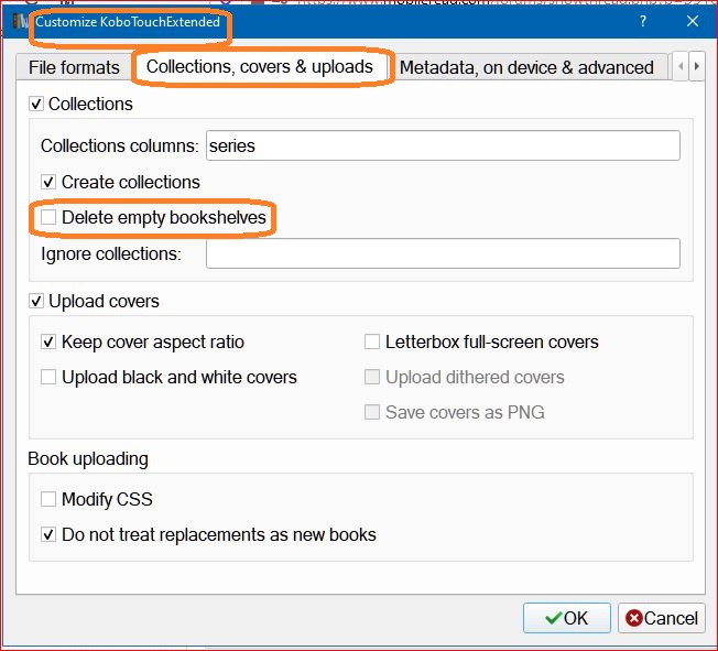

Old 10-31-2019, 04:42 PM   #9
Posts: 31,356
Karma: 62500000
Originally Posted by Chocky View Post
To update,
collections are now recording the books on the device in the right place, so that's all good.
Still got 8 pages of collections showing 0 books as I haven't, and might not, load them onto the device.
How can I get rid of all those collections with 0 books?
Right click The Kobo (plugin) Icon: Driver: Configure current driver- Extended...
See attached image
Old 10-31-2019, 04:53 PM   #10
Chocky
Chocky can program the VCR without an owner's manual.Chocky can program the VCR without an owner's manual.Chocky can program the VCR without an owner's manual.Chocky can program the VCR without an owner's manual.Chocky can program the VCR without an owner's manual.Chocky can program the VCR without an owner's manual.Chocky can program the VCR without an owner's manual.Chocky can program the VCR without an owner's manual.Chocky can program the VCR without an owner's manual.Chocky can program the VCR without an owner's manual.Chocky can program the VCR without an owner's manual.
Chocky's Avatar
Posts: 398
Karma: 162138
Join Date: Jul 2012
Device: Kobo Touch
See attached image
Unfortunately that is already checked.
Chocky is offline   Reply With Quote

Old 11-01-2019, 09:35 PM   #14
davidfor
Posts: 24,905
Karma: 47303824
Location: Sydney, Australia
I've looked at the log, and, you haven't done the configuration properly. The log has the following line:
DEBUG:    0.0 KoboTouch:books - prefs['manage_device_metadata']= manual
That will mean that the metadata changes won't be done automatically when the device is connected. In the thread linked to above, there is a link to the Wiki page with instructions for configuring the collection management. This is https://wiki.mobileread.com/wiki/Kob...nd_Collections. You need to do the bit under "Configuring calibre's Metadata Management options". Setting the option to automatic works best. And, the last statement in that section is:
If the option is set to Manual management, shelves will NEVER be removed.
Old 11-02-2019, 03:49 AM   #15
Chocky
Chocky's Avatar
Posts: 398
Karma: 162138
Join Date: Jul 2012
Device: Kobo Touch
Thank you very much, that sorted it.
Don't quite know how that happened because I've used Calibre for years and it's been OK until the new Clara HD
