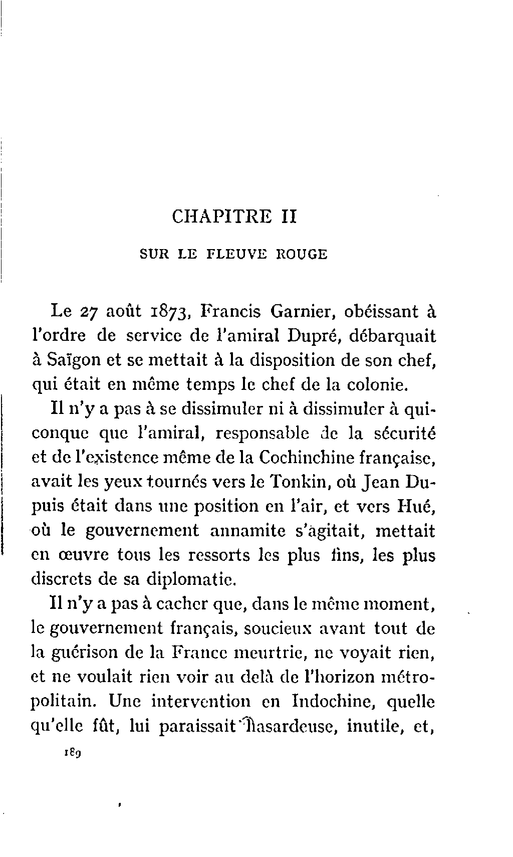

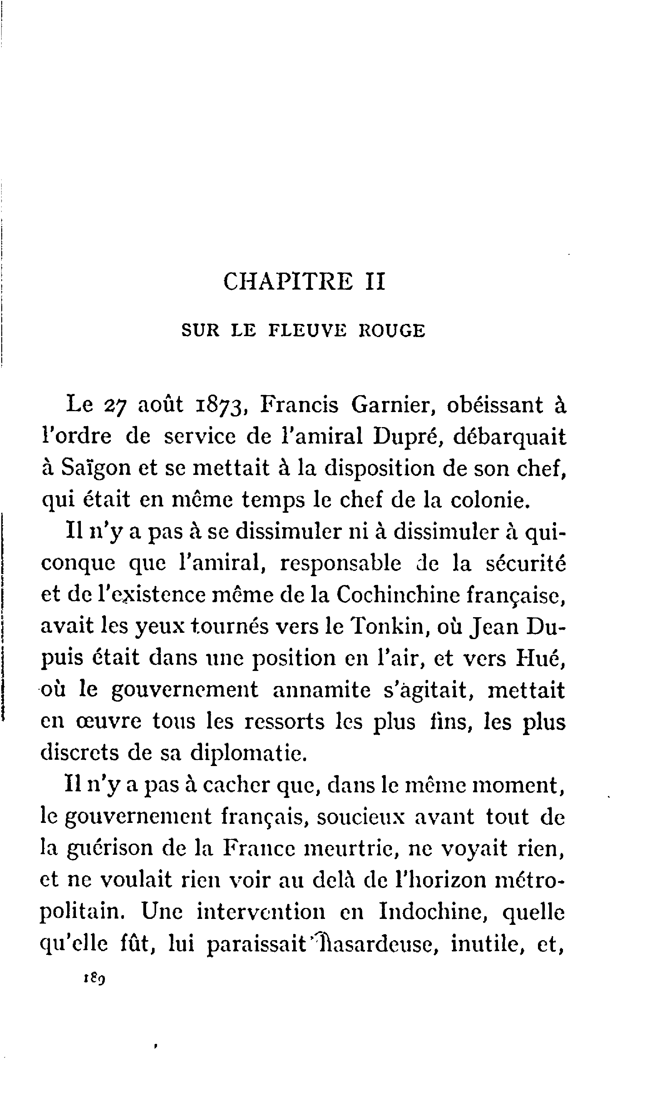

In order to pre-process image files with scantailor, I may have to convert some source PDF to png files.
There are some online services that do this, I prefer doing it using imagemagick.
Second try on a 14 pages pdf extract from a bigger book gave this:
convert: profile 'icc': 'RGB ': RGB color space not permitted on grayscale PNG `garnier.png' @ warning/png.c/MagickPNGWarningHandler/1748.
[roger@lenovo roger]$
It converted nearly instantly all the pages which is pretty good but I am not sure to understand the information above. Has somebody some knowledge about it?
Even adding parameters like -quality 100, or -density 300, one such image has a 27k only size, while the same image processed with, say pdfcandy online service at medium resolution has a 55k size (see screenshot). Does this difference may hinder the ocr process later?
The second image (001) comes from pdfcandy
ID:	173226   Click image for larger version
That warning can probably be completely ignored.
From what I could tell, what's happening is that ICC (color) metadata from the PDF is being embedded in the PNG... (see technical note below).
If you want the warning to go away, and don't care about the metadata, just add a -strip:
You could continue to add whatever other adjustments you want:
You could also remove the transparency and make the background white:
convert -density 300 -strip garnier.pdf -background white -alpha off garnier.png
or even use the mogrify command instead:
mogrify -format png -density 300 -strip -background white -alpha off garnier.pdf

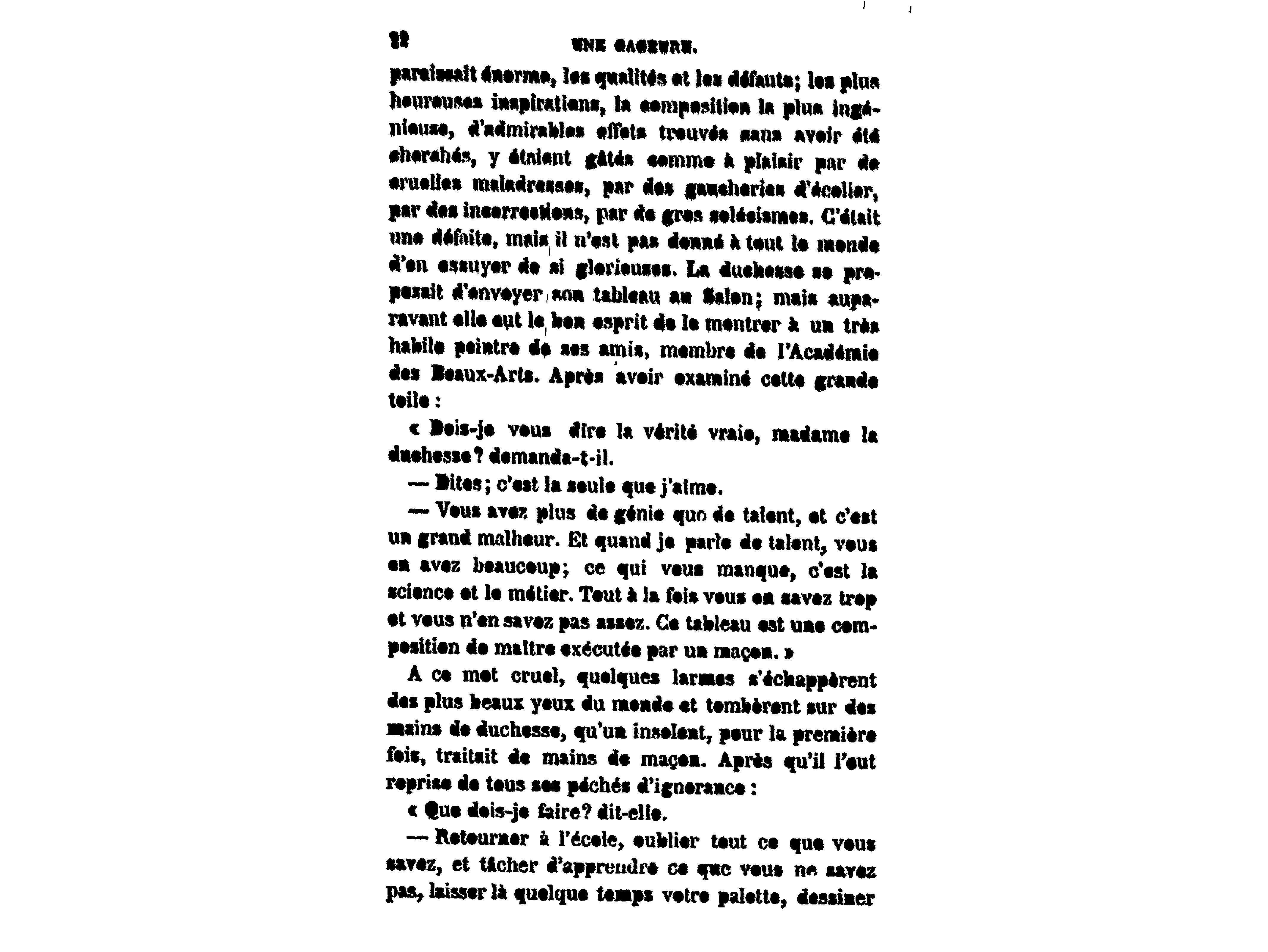

Get the PDF into PNGs:
Since that PDF is awful, and has enormous whitespace around it, I would suggest trimming:
that would focus more on the text itself.

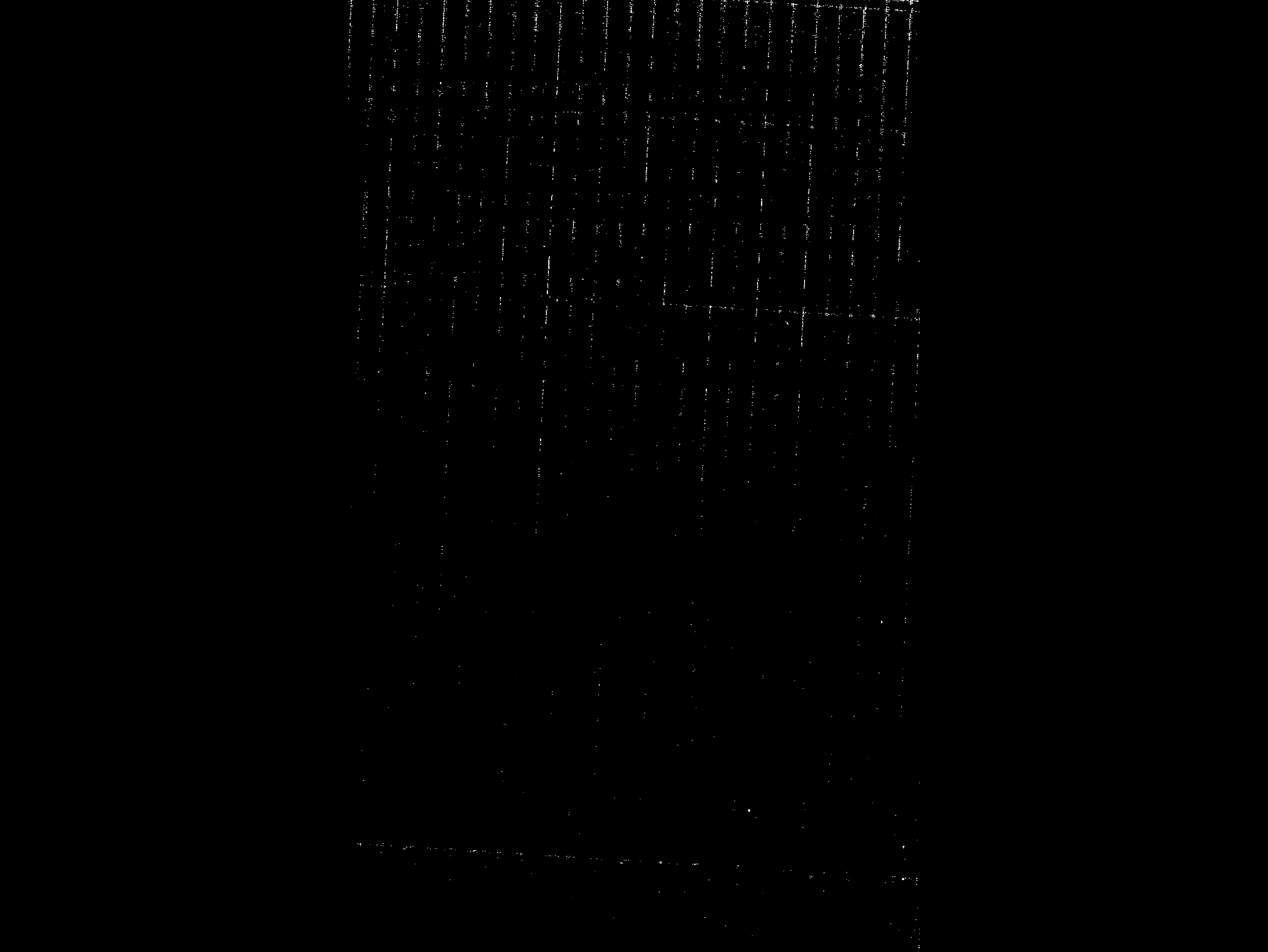

convert output.png -connected-components 4 -threshold 0 -negate output-negate.png
Step 3
It seems like area-threshold looks for "chunks of pixels that are X pixels or less".
I tested with area-threshold=30:
convert output.png -define connected-components:area-threshold=30 -connected-components 4 -threshold 0 -negate output-cc30.png
but I found that this PDF needed more. So I adjusted by 10s all the way up to 80:
convert output.png -define connected-components:area-threshold=80 -connected-components 4 -threshold 0 -negate output-cc80.png

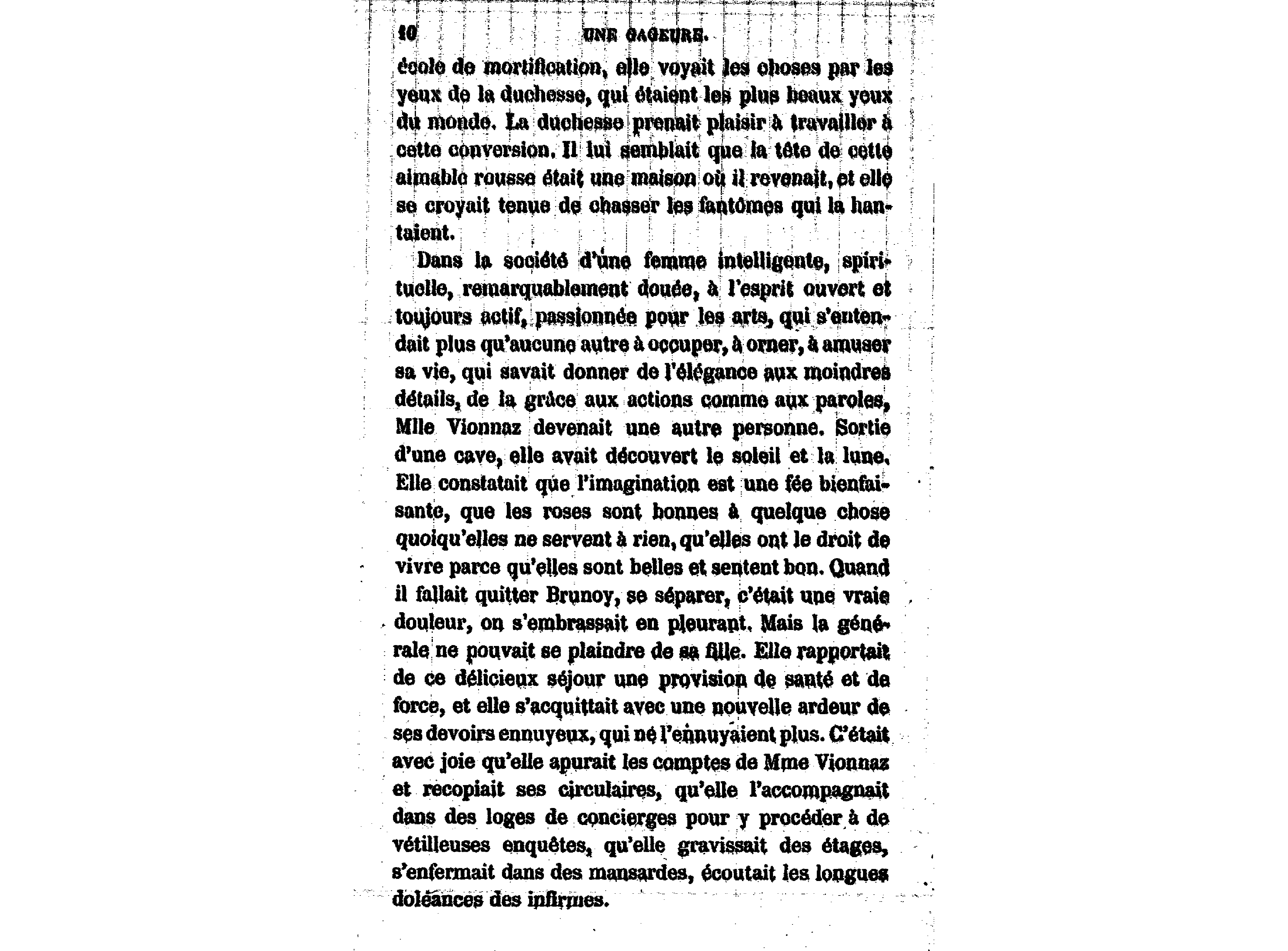

Then I was able to take image from Step 1 + Step 3 and create a diff:
convert output.png output-cc80.png -compose minus -composite output-diff.png
Step 5
Then use the images from Step 1 + Step 4 to remove:
convert output.png ( -clone 0 -fill white -colorize 100% ) output-diff.png -compose over -composite output-diff-composite.png
Here's the Original (Step 1) + Diff (Step 3) + Cleaned (Step 5):
ID:	173267 Click image for larger version
ID:	173268 Click image for larger version
