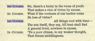

For my sins I'm grinding through the George Eliot novels for the MR library. Most of them have epigraphs at the beginning of each chapter - some of them quite long and with several layouts.
The attached image is part of the epigraph for chapter 5 of Felix Holt, the Radical. I gave up on this, but there is a similar layout in chapter 38 of Daniel Deronda and I want to try again.
Can anyone point me please to a method of setting up the epub markup to produce this effect? I want it to show well on 6" readers, so the lines will very likely need to break. And of course I want it to show well on a Samsung tablet and an iPad, where the lines will not need to break.
If I could remember how to do spreadsheets in HTML I could probably work out a spreadsheet which would do the job. Can anyone point me to a tutorial for doing spreadsheets in HTML?
And I'm afraid a final complication is that I do all my ebooks with an HTML editor, so techiques using Sigil et al probably won't be much use to me.

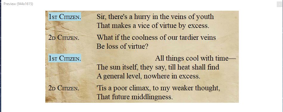

Not sure what you are going for here....Sigil doesn't have any "special HTML techniques". If it is ePub compliant HTML then it doesn't matter where/how it was created, it will work fine in Sigil. And the opposite is true - HTML made in Sigil will work in any standards compliant device/app.
As far as your epigraph example - The HTML term you are looking for is "Table" instead of spreadsheet. There are, of course, ways to format without tables, but it seems that your example would be easiest created using a table. You can refresh your memory about the techniques of tables in the W3Schools tutorial/reference.
Here's a quick example:

Just playing around a little more....
The highlighted portion looks like someone was just marking the book so they could memorize their lines...
If you don't want to replicate the highlight, you could simplify the code like this:

This uses the ::first-child selector on the <td> to style the first column. Depending on how old the device is, it may not support that selector.
Also, Alex, you might want to look at media queries if you want to use different css for different devices (small screens vs tablets, old devices vs new devices, etc).

The best I can do with current CSS functions is specify where a line breaks and use hanging indents for any reflowed portions.
*shrug*
edit: Or you could set the epigraph/image on it's own page and use an SVG wrapper.

Hi:
I'm not going to lie--I stayed out of this discussion because I wasn't clear on what you were really trying to do; initially, it seemed that you wanted lines to NOT break at all, on larger eReaders (although how you'd do that in a world of fonts that can be resized, I don't know), but break on smaller--but now you're saying that you wanted the lines to break "in a standard way." What does that mean?
Hitch
Thanks for your response, and please accept my apologies for not being clear. What I meant was to have each line of the poem break at the right edge of the screen if it is too long for the width of the screen, and to continue with a 2em indent on the screen line below. The 2em indent of course is to show that the words are continuations of the line above, and not a new line of the poem.
It's quite easy to do with most poetry, even when a given line of poetry is itself indented a space or two. But I found it impossible to do on a six inch screen when the whole 'verse' is indented and preceded by a character name as on the epigraph I attached. It might have worked on an iPad screen, but I wanted it to work on a 6" reader and a Samsung tablet as well.

I've long since given up trying to duplicate the printed version. It's just not possible or, IMO, desirable.
I entirely agree. But I have been the recipient of flak in the past for not duplicating the text even where the meaning of the English words has changed.
For example, in my opinion, the phrase 'some gay young men' in the 21st century means something quite different than when it was written in the 17th or18th centuries. Should I have left it as written by the 19th century author even though it was clearly not what she meant in her time?
