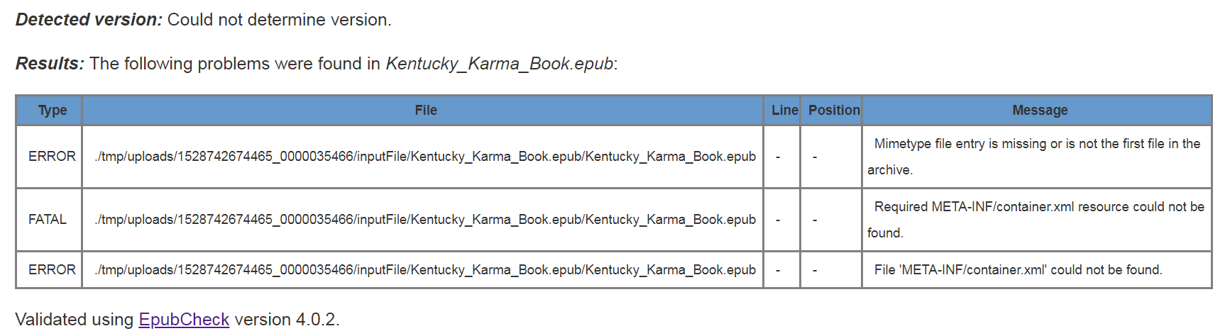

I have attempted to do what was suggested - looking inside the content.opf file
... but in all likelihood, did not go about it the correct file. I opened the file in dreamweaver and found the line:
<dc:date>*September*</dc:date>
And changed it as suggested. However, when you resave the file with dreamweaver it adds the suffix xhtml to .opf, so it reads: opf.xhtml
So I then renamed the file by omitting the .html
I then rezipped the contents and changed the file type from .zip to .epub
When I did this method and redid the validator, I now have this error:
Name:	Opera Snapshot_2018-06-11_144819_validator.idpf.org.png

The error messages seem to suggest you now have an epub file contained within the epub.
Start again and this time either use Sigil or Calibre's epub editor or use basic tools such as 7-zip to open the epub file and the editor in 7-Zip to make the edit to the opf file, then when you save the modified opf it should update the archive (epub)
BobC
