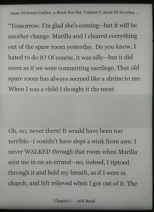

I have the same issue (I think), just much more profound. It has been laying on my desk, and battery ran dry, for about 6 months. I went to use and center of the screen is blank for pixels, but is still responsive if you can guess what lies beneath.
I've tried fully charging it, resetting it and a full factory reset... to no avail.

It doesn't look like a broken screen. I've never see a rectangular area in the middle of the screen. I'm thinking it could be a screen controller gone bad.
