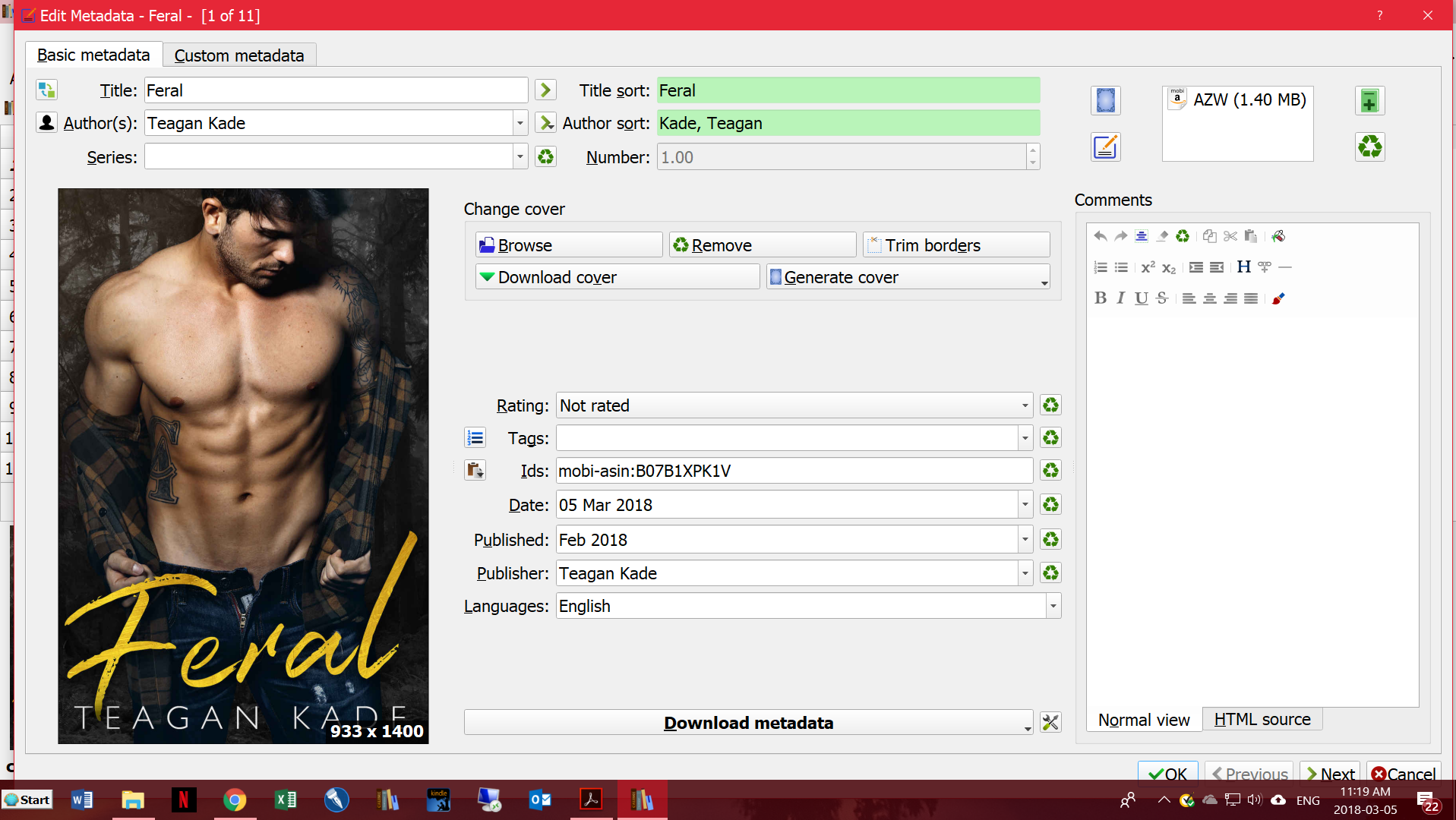

In my Edit Metadata the author sort comes up as: Last name followed by first name.
How can I change this so that it shows as First name followed by last name, just the way it is in authors
mamaijee
screenshot enclosed
Name:	for calibre.png

Preferences:Tweaks
(I'll let you use the search there for: sort order)
This only applies to NEW adds.
THEN
to fix existing
Select all books (assumes all are wrong): Tap 'E' (bulk mode metadata edit), Tick the Automatically set Author sort: OK
That recomputes it using the new rules

The description of the tweak has the list of valid values. The rest of the line is a description or examples. If I understand what you want from the first post, you need to use "copy". This will fix all new authors added. The tweaks description has instruction on fixing the existing ones.
