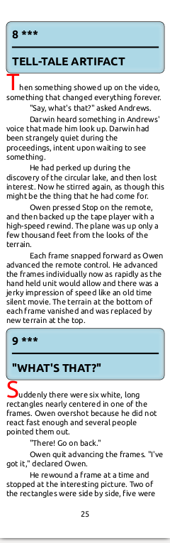

strange dropcap behavior with/without merged xhmtl
h1 ~ p:first-of-type, /*use for split xhtml */
h2 + p /*use for merged xhtml*/ {
text-indent: 0;
/*unindents first p following every h1*/}
h1 ~ p:first-of-type:first-letter, /*use for split xhtml*/
h2 + p:first-letter /*use for merged xhtml*/ {
color: red;
font-size: 3em;
float:none;
line-height: 0.5em;
/*float:none makes TALLcap*/}
If you split xhtml segments at every <h1> you can use the pseudo code to create dropcaps at the first letter of the first <p> following every <h1> when converting to PDF. If the xhtml segments are merged into a single file (to avoid page breaks before <h1>) then the pseudo code does not function and there are no dropcaps. Of course, normally, you would NOT merge the <h1> xhtml segments; I did that to prevent page breaks before every <h1>. However, if you also have <h2> subchapters you may actually want to prevent page breaks between every <h2>. If so, the above code for <h2> is a "work around" which lets you make drop caps no matter if the xhtml segments are merged or split. These are TALLcaps because dropcaps (float:left) are not well behaved. Best regards, Pop

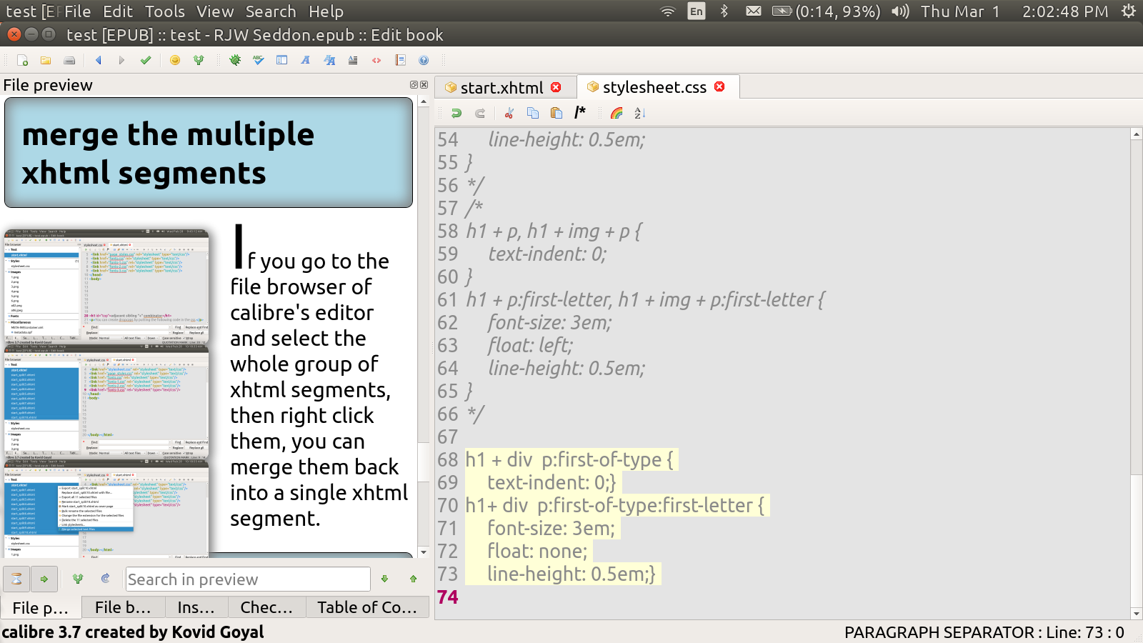

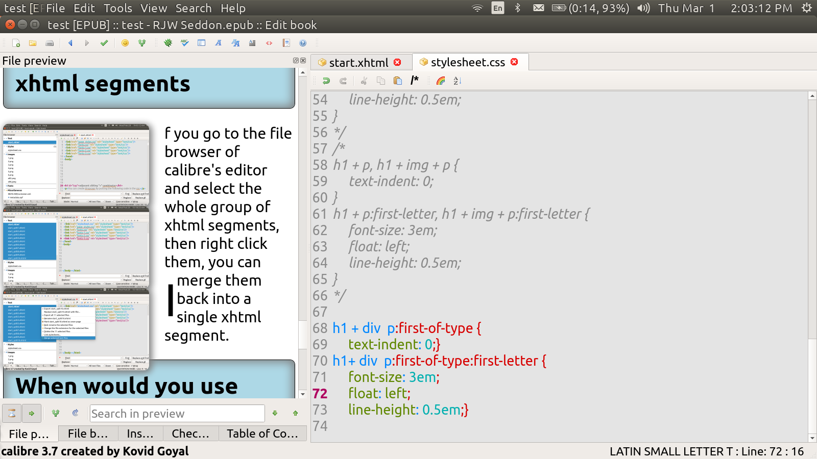

I cannot thank you enough for that explanation. This is the code I used:
h1 + div p:first-of-type {
text-indent: 0;}
h1+ div p:first-of-type:first-letter {
font-size: 3em;
float: none;
line-height: 0.5em;}
However, there is still a tiny problem. If I use float:none TALLcaps are produced (in correct locations). If I use float:left DROPcaps will wander away from the correct location if they are behind half-width images.

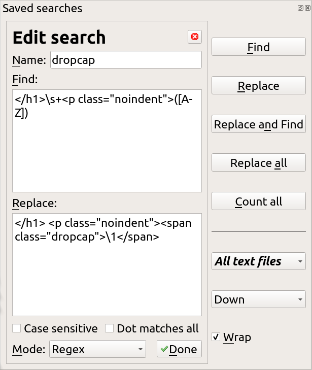

regex dropcap
Wow! That works really good. I copied and pasted it into the calibre editor in the Saved Searches box so that I don't have to reinvent the wheel each time. Thank you. Best regards, Pop
