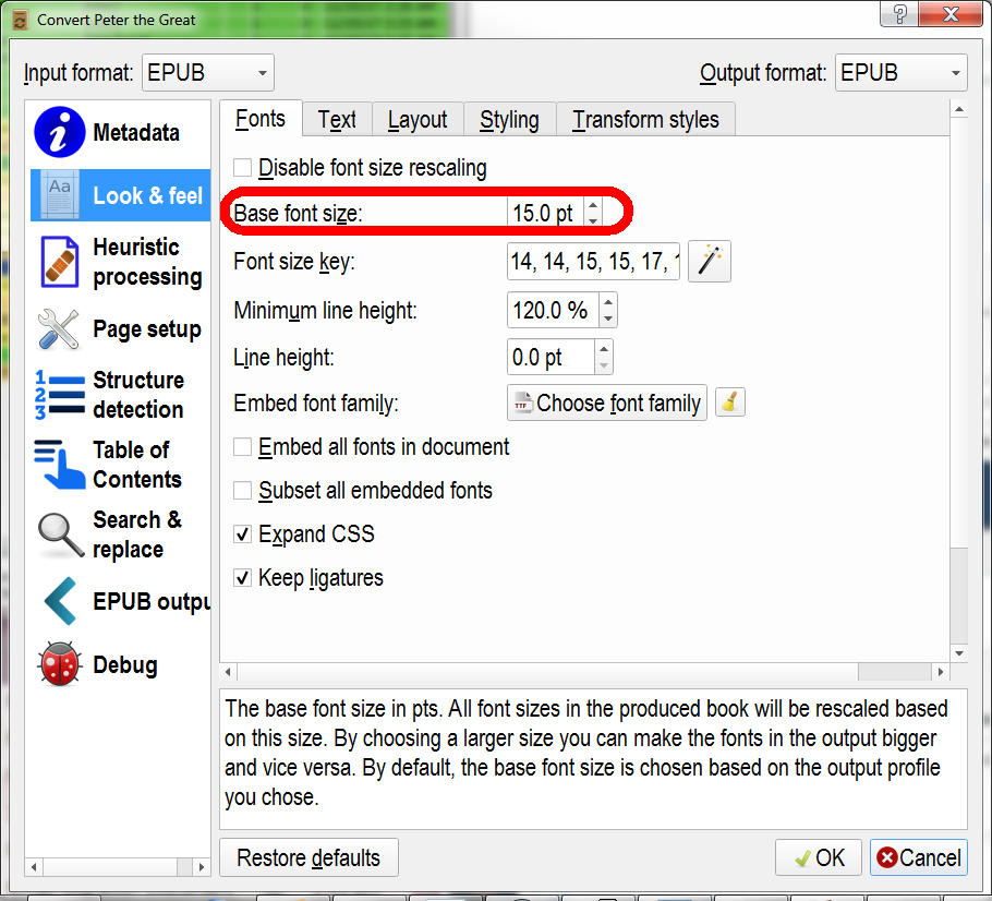

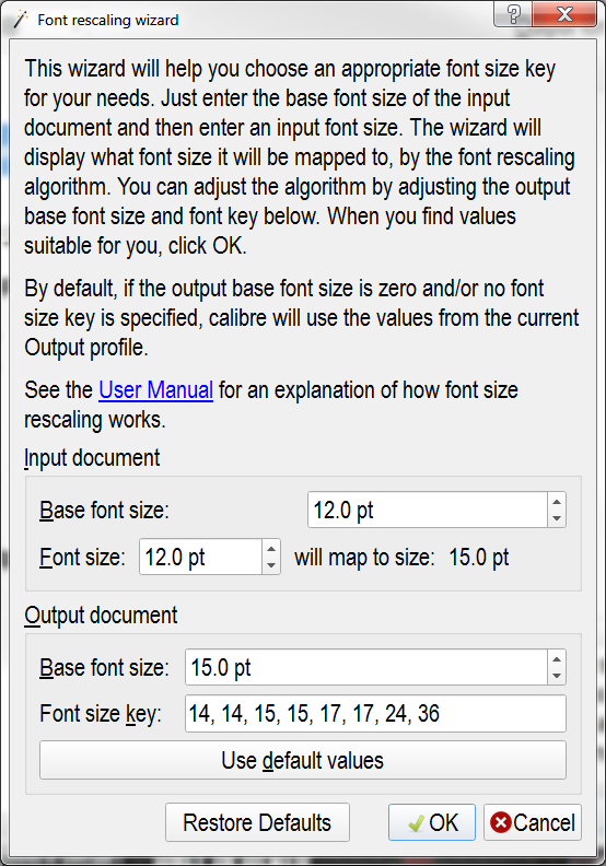

Originally Posted by Cthulhu4u View Post
I use Calibre to convert books to AZW3 for use with Kindle and Kindle apps, but I have a problem. Is there any way, during a mass conversion, to make sure that all books have the same base font size.
Maybe if all of the input ebooks have the same base font size. If you uncheck Disable font size rescaling, see attached, you can specify the base font size used during conversion.
I use this on a case by case basis when after converting I find the fonts are too small. See attached for my settings.
Name:	base font size.png
ID:	160017   Click image for larger version
Name:	font rescaling wizard.png
