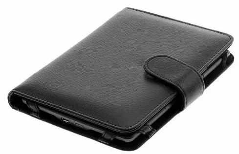

Yes, I use a case. Could the leather cover prevent it from downloading at full speed?
I attach a photo of the case.

Have you tried downloading a book at a different WiFi connection? That way you could determine if it is a problem connecting through your home WiFi, or if it is a problem that the Kindle has with any WiFi connection.
I doubt the case is an issue, but you could try it out of the case just to rule out that possibility.

Once I am at home I'll try to download the books without the case.
Not likely.
So do I.
I admit I am grasping at straws here, but just maybe there is something about that case we can not see (metal stiffing inside the leather? ).

Issue resolved. I restarted my modem and removed the case. One of both factors fixed the problem.
Thank you for your help!
