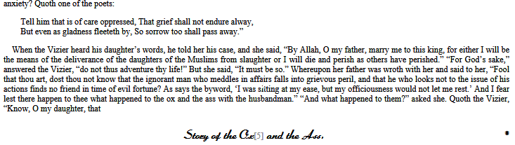

As I announced elsewhere, I'm working in "The Book of the Thousand Nights and [One|A] Night". I've more or less finished formatting the first volume of Payne's translation Burton's will take a bit longer because it has more and longer footnotes, and the PG text is worse.
Here is a preview of what the book will look like, still missing cover and some information, but I want to show the preview because it's a bit fancy, and I hope to get some feedback (whether it works and whether you like it).

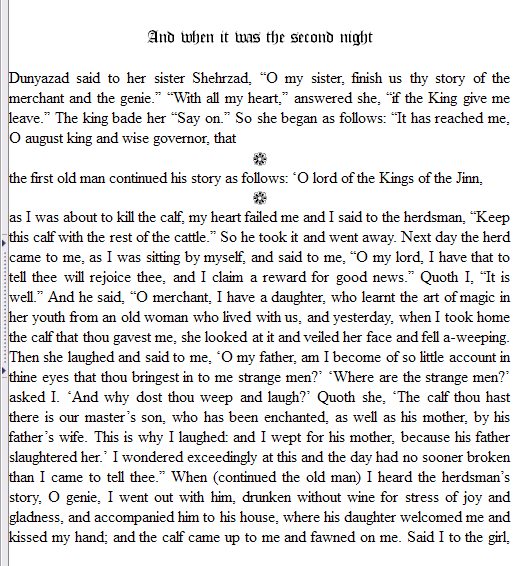

Some decisions: Payne's translation does not divide the text in nights, it simply adds the night numbers as sidenotes. I've decided to add the night headlines to keep some of the "feeling" of the wrapping story (Shehrzad/Scheherazade interrupting the story every day and continuing the next night). For the same reason, in Payne's and Burton's translation I've set the nights as "chapters", besides, having the stories as "chapters" would be a daunting task, given the complex nesting, especially in this first volume. Nights are a bit more uniform in size, and pagebreaks there are more appropriate.
Neither translation has any explicit formatting for when a story ends or is interrupted, I've added some dingbats: a large closing quote when it ends, a flower when it is interrupted or resumed (see pages 27, 28, 41, 52 in the pdf). I've also added a large asterisks in the caesura of verses (Burton does it, Payne only uses the capital letter) to ease the long lines. Finally, I've added some stars to the right of the story titles, marking the "level" of the story to help keep track (the more stars, the deeper the story is). All these marks are added with generated content, so they will probably not appear in most epub readers, but there will be at least linebreaks, I hope; I might add the marks explicitly in the final version. (Actually the marks are added in an alternate stylesheet, so ideally it should be possible to enable/disable them on the fly; this is the case if you open the xhtml files in a browser and use, for instance the context style switcher firefox plugin.)
There are two tocs. One for nights, indicating when stories start or end (but not which story), and another for stories, indicating which nights start during each story (not including sub-stories).
I'm attaching the epub and a pdf to serve as a kind of reference rendering.

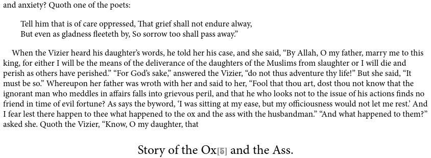

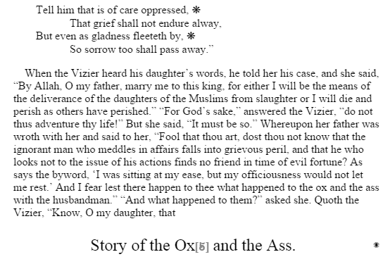

I really like your book design. One can clearly see that you put a great deal of thought into it. For example, indicating the narrative structure with dingbats in the stories TOC is a neat touch that none of the other 1001 Nights editions has.
The only thing I don't like is the decorative font that you've chosen for footnote numbers because they're not very readable. For example, the 7 looks like an upside down 2.

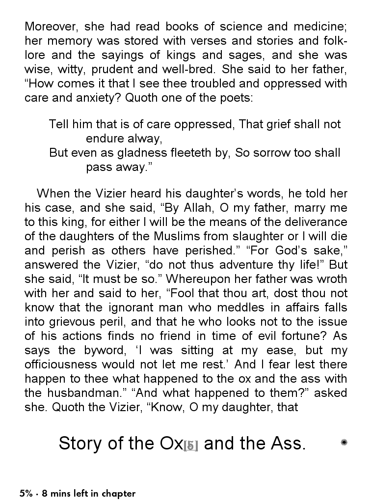

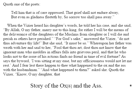

Unfortunately, there doesn't seem to be a reader that will faithfully render all fonts and styles that you've used. I've tested the original ePub2 file and a Sigil-converted ePub3 file with ADE4, Readium and a Kindle PW2 (which uses a Webkit rendering engine), and only Readium displayed (almost) everything correctly.
Does your Kobo Aura display everything as designed?
I haven't tried yet, but I don't think it displays any of the :after pseudo-elements. Hopefully, most of the problems will be solved if I include the dingbats explicitly rather than through CSS.
