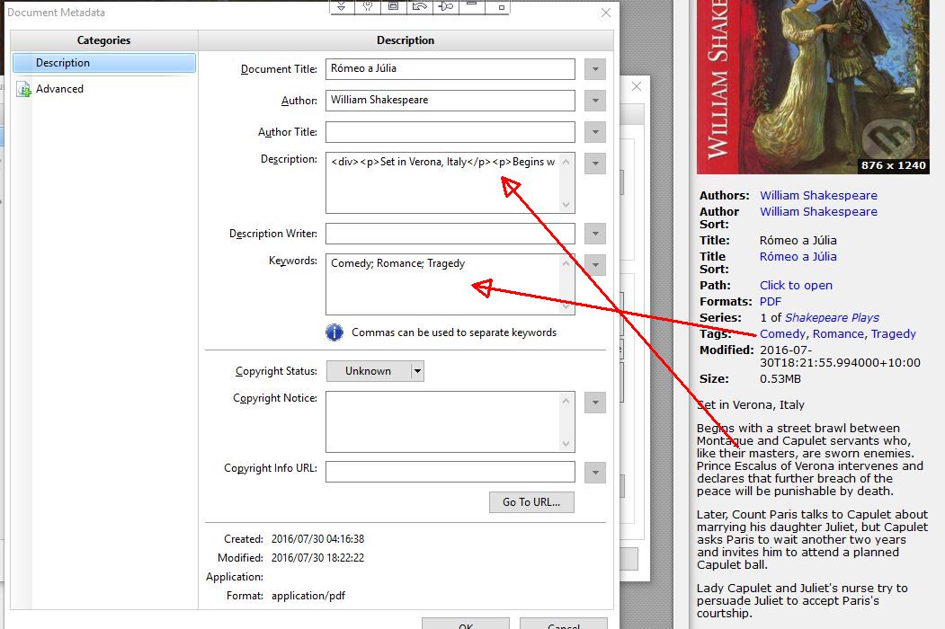

Thanks your your reply. I tried to set the metadata using programe "Pdf Metadata Editor". But It did not help. Look, I think that it is set correctly: https://drive.google.com/file/d/0B4o...ew?usp=sharing Can be the problem in "Device configuration" options? Which should be checked?
Embed Metadata works on that PDF to an extent (select book in book list, press Ctrl/E, select PDF, click OK). I use Tracker Software's PDF xChange viewer - here's what I see there.
I can't answer your Device configuration query.
