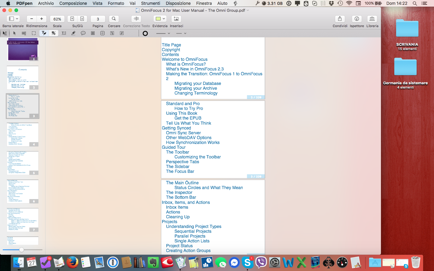

Converting from epub to pdf
Hi everyone, I have an issue converting epubs to pdf. I usually use epubs, but using a lot of devices and apps, I sometimes need it this way. The result is actually acceptable, in that it looks like the original and doesn't have the problem elsewhere reported, but the pages are many more than the original file and are nearly squared. I think it's a settings problem but I'm not a power user and I have problems understanding them. I have attached my settings and the final result. Could you help me to fix this problem?
Thank you in advance,
Massimo

Take a look on picture "Schermata 2015-12-23 alle 19.46.34.png"
You forgot to define your paper size (custom or predefined). Don't forget the check box above "overwrite paper size ..."
In the calibre manual you will find some additional fine tuning tips for PDF: http://manual.calibre-ebook.com/conv...-specific-tips
Take a look on chapter "Converting to PDF"

Thank you very much, I made it!
