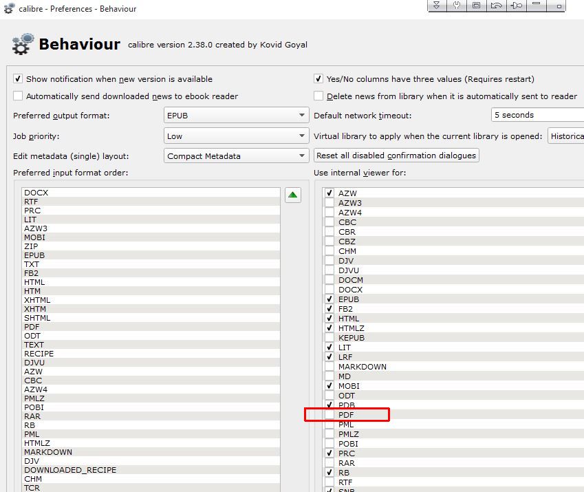

@mitch13 - In calibre uncheck Preferences->Behaviour->Use internal viewer for->PDF and ensure PDF has Acrobat as its Default in Windows.

@mitch13 - I am confused, are you saying if this setting is checked then from calibre the PDF opens in Acrobat :
And if its unchecked it opens in the calibre viewer - that's arse about face.
What happens if you open the book folder - press 'O' - and double click the PDF, does the PDF open in Acrobat?

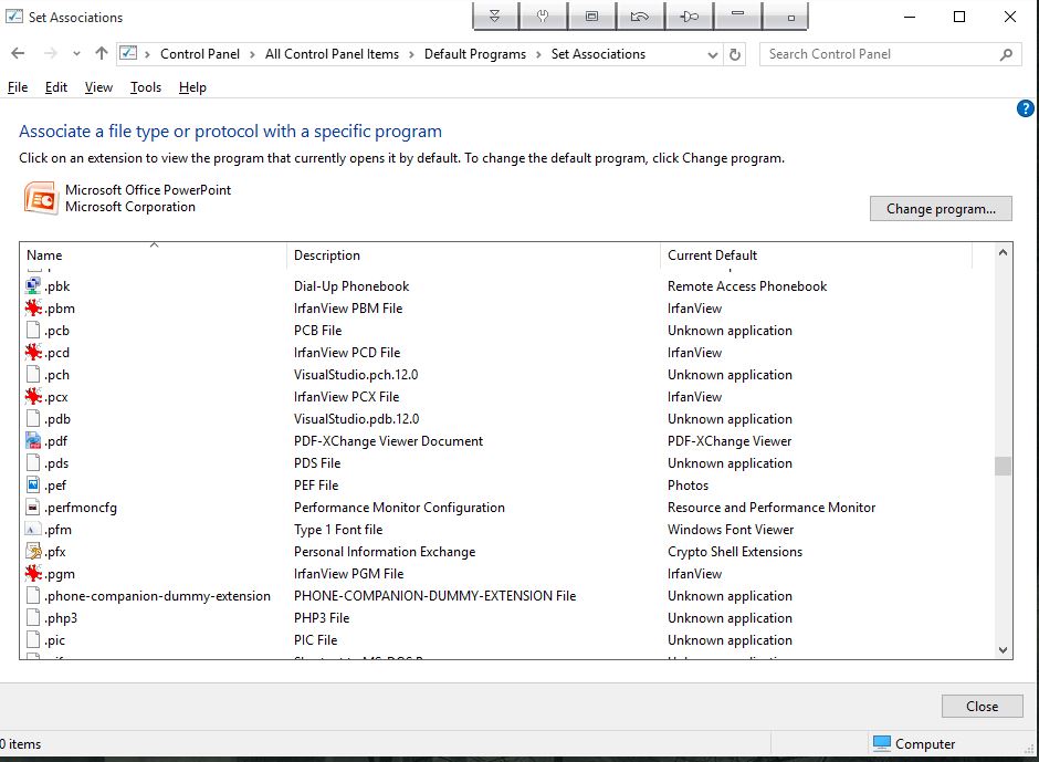

And what do you see here - if its not Acrobat change it to Acrobat
